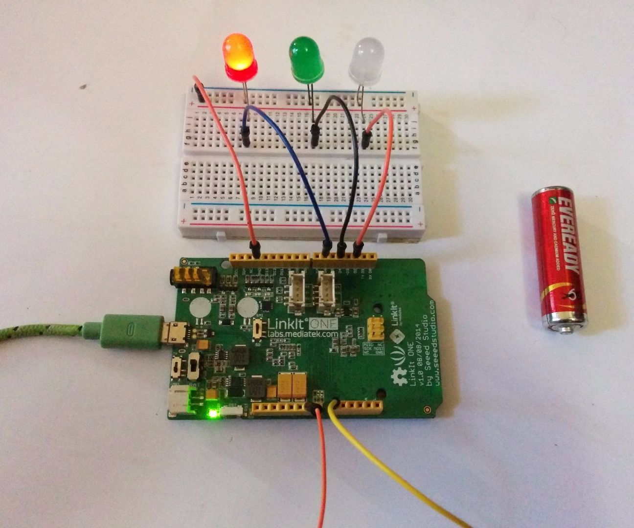

Step 2: Circuit
There is not much of a circuit all you need to do is connect digital pin 6 form the Linkit One to the speakers with the help of alligator clips. I used a 3.5mm Jack to make the connections much more simpler. You need a speaker with an internal amplifier or you wont be able to hear any output form the Linkit One. And connecting a speaker directly to an Linkit One might burn the board.
