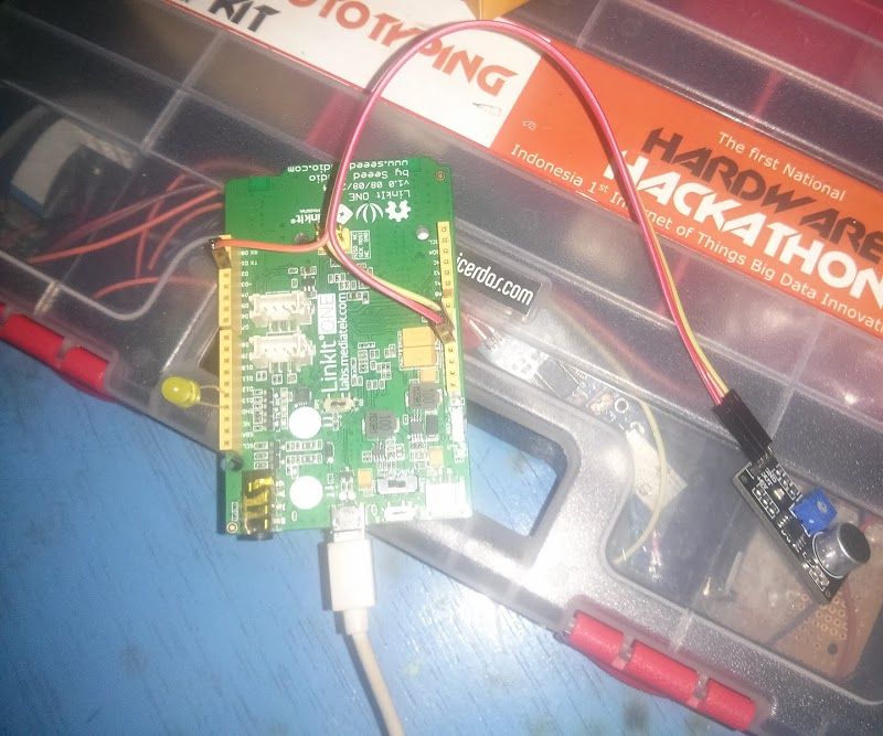

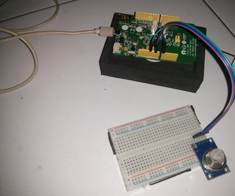

Step 3: Setting the Hardware
The linkit one board comes with 3 antenna. This tutorial will use wifi connectivity to send the data so the wifi data need to be attach to middle antenna port.
take 3 Jumper Wires and set the LDR and 1k Resistor just like in the picture. The Analog Pin A0 will be used to read the sensor data
