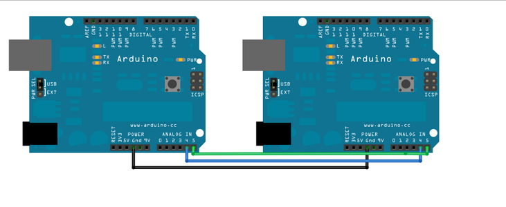

Step 3: Circuit
The schematics can be found in the above image, analog pin 4 and 5 of the Arduino act as the SDA and SCL pin. We also need to connect the ground pins of both the boards together. You can also power one board using the other like I did.
