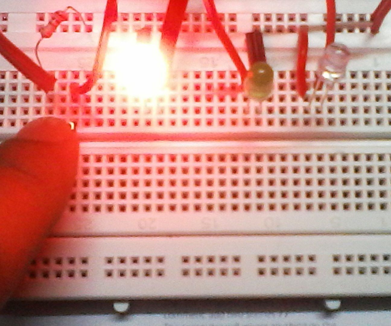

To switch on different colour LEDs as a result of pressing the switch.

Step 3: Connect - Resistors
Step 1
Take an arduino and connect it with your laptop.
Step 2
Take a breadboard and place a switch on it.
Step 3
Connect one side of its leg with digital pin 2 and ground it with a 10 KiloOHM resistor.
Step 4
Connect 5 volt pin to another side of its leg.
Step 4: Connect - LEDs
Step 5
Place 3 LEDs on the breadboard and connect their long leg with 5 volt.
Step 6
Ground them with the help of 220 OHM resistors.
Step 5: Try It
Now power it up and test it out.
