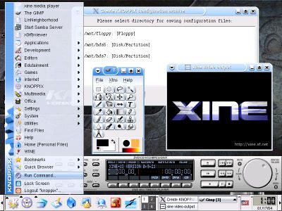

How to boot Knoppix (cd or dvd data) from a USB dongle:
I will describe below how to format a fat 16 partition on a USB dongle and make it DOS bootable and automatically launch a dos version of grub which will start knoppix from the iso cd image (+kernel +inird files) all located on the USB dongle:
1) Download GRUB: http://s94002264.onlinehome.us/grub/grubh.zip
2) Extract the directory grube.zip\Grube\Root_Of_USB
3) Launch the GREAT program HPUSBFW.EXE (under XP only, sorry), and follow the instructions and when prompted, point to the system files included in the Root_Of_USB directory
4) copy the rest of the files of Root_Of_USB into the root of your dongle (but do NOT overwrite the io.sys)
5) copy the files required to boot linux: kernel, ramdisk and iso (linux, minirt_ntfs.gz, knoppix.iso) (you can download the various customized version of the INITRD_NTFS.GZ ramdisk required to boot from an ISO file (even if the filesystem is not ntfs but a fat or ext2/3) here:
http://s94002264.onlinehome.us/grub/kno402u.zip for knoppix 4.02
6) modify the menu.lst file to match your need
(path to the kernel and initrd file + kernel boot options, cf grub and knppix doc.
But be very careful, the path is case sensitive !!!)
7) setup your bios to boot from usb, reboot and have fun...
