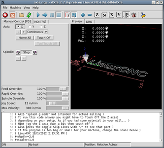

You should have a LinuxCNC shortcut for the configuration you created. Load it. The program loaded by default is AXIS and it has a great GUI as well as a direct gcode interface. In the upper left are two buttons. You will need to enable both of them to be able to move your motors.
Verify all axes move, move in the correct direction, and move the correct distance.
If an axis moves the wrong direction, change the scale value for the axis to be negative.
If an axis moves the wrong distance, correct the scale value for the axis.
If an axis does not move, verify the pin mapping is correct.
Note: AXIS will note any errors and not launch if there is something wrong. Don't worry, this absolutely will work in the end, but the configuration files are easy to get wrong. Go back to the Byte2Bot reference configuration. It won't necessarily just work but it's a good reference.
