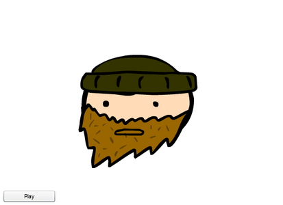

Step 2: Key Frame Lip Syncing
The first is one of the simplest methods, and is the base for several others. it provides one of the easiest ways to get a fairly authentic mouth movement with the least effort, other than the binary method which is just drawing a circle for whether the mouth is opened or closed, which i wont go into.
This method is key frame sounding. What this means is that you draw your mouth movements at the points where there is the most change, which would be when pronouncing a different sound. e.g silent to "GA" or "TA" to "MOO".
Once you master this method, the others will be much easier, which essentially just go further into this one.
Once you have your audio set to streaming, and your characters face all ready to go, drag the frame marker over the frames and listen for important syllables that would have the most impact on how the mouth is shaped. e.g AH EE OO EH OH and AY . If you ever learnt Japanese its essentially the Japanese vowels in most cases
Now draw on those frames the mouth for that sound. In several methods this is how you start . My example is the hobo from my parody saying i am a hobo, embedded are 3 versions for the steps you need to take.
As i said, first is to just draw the biggest changes in sound as well as what would create the most change in mouth shape.
Next is to right before and right after each of these mouthed sounds, to put in a transition, what the mouth should look like right before or right after that sound. Its best to keep a frame or 2 between key frames if there is a lot of distance between the sounds you've sounded . in many cases the sound right before or after will be something like te , be ,pe, ect. dont sound those with a closed mouth.
Lastly, wherever applicable, draw a closed mouth. Don't use it too much though or else it sort of ruins things. In this example i have changed the syncing option from stream to event, so you can see what kind of difference it makes in audio quality

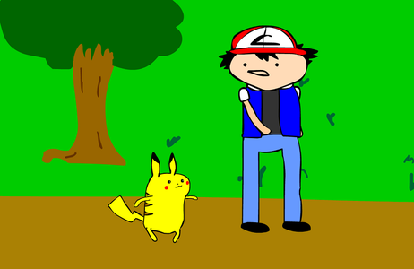

Step 4: Frame by Frame Hand Animating
This method is my preferential favorite as i always wind up getting it to look more or less as i want it to.
Essentially this method is just filling the gaps like the tweening method, except, you draw it by hand, wherever you can.
This method is preferential to tweening whenever the characters head isn't in motion or when you are using pre-drawn mouths that would take too long to alter/ redraw correctly.
The only trick is to always make sure you are drawing the right shape for the mouth and at the right time, namely not closing the mouth off to a line because of silence during the middle of a word.
The example of frame by frame is a few clips from my pokemon parody.
The first scene is an example of full frame by frame animation, hardly used professionally, but still as effective. Essentially i hand drew every single frame used in the speech with no gaps or pauses.
The next scenes however, i use something more along the lines of key frame syncing. The hobo when saying "change", is shape tweening, as that is an appropriate time to use a tween. Being a shape tween, it maintains stroke width while morphing.
As you can see, full frame by frame when done right, is very smooth and effective, however if you look carefully at it, pacing it right, youll find it doesnt really match up exactly how it should be expressed, but unless you look really hard you dont see it. This is what i mean, whether its a bit off or right on the dot, it always works. The more breaks and pauses used however, any errors become much more apparent.
