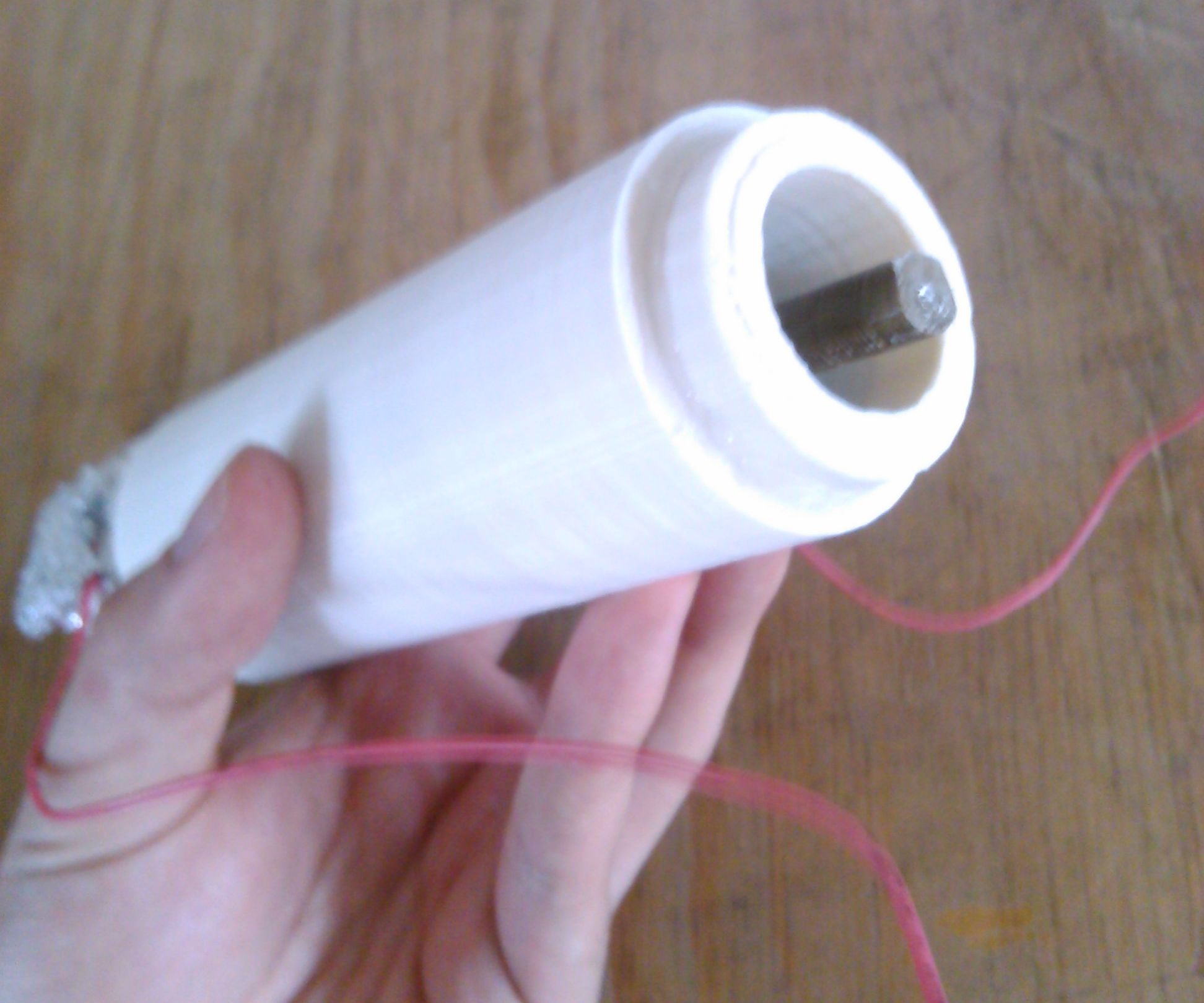

Step 1: Waterproof Concentric Tubes
The sensor works with two pieces of aluminum inside of two waterproof concentric tubes.
You can download the parts and their 3d models to print them here:
- Inner-tube (Download here: https://tinkercad.com/things/kXxsoB93nmm)
- Cover of inner-tube (Download here: https://tinkercad.com/things/giTC8AwXGqB)
- Outer-tube (Download here: https://tinkercad.com/things/k2057MmqnBM)
- Outer-tube cover (Se puede descargar el modelo aquí https://tinkercad.com/things/lXDHiUf4tj1)
Step 2: Cover the Tubes With Aluminum Foil
Step 3: Assemble the Tubes and Their Covers
- Introduce the inner tube covered in aluminum foil in the inner tube cover.
- Introduce the external tube covered in aluminum foil in the external cover.
- Introduce the inner tube in the outer tube and glue them together with hot glue.
- Make sure that when the tubes under a liquid the liquid does not touch the foil.
- Solder a cable to each piece of aluminum foil.
