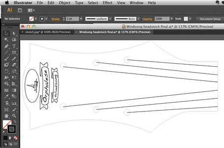

Step 2: Design the Laser File

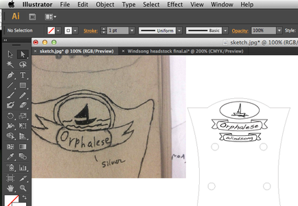

I designed the file in Adobe Illustrator, but any similar graphics program will work. My design was the guitar's name - WindSong - combined with a logo by pretend maker "Orphalese". In short, the name and logo are inspired by part of one of my favorite books. I discussed more about the story behind my designs in my carbon fiber acoustic guitar video page.
Process
For example, with the laser be aware of charring when making fine details. Although the width of the laser beam is only a few thousandths of an inch, if making a deep pocket you can end up scorching a wider area. By choosing a very small font size, I lost the center parts of letters with loops, like the "O" and "e".
Also, though this inlay was small, when experimenting with larger images, I've noticed that the inlay sags under its own weight towards the middle, creating a depressed inlay when it dries. If making a larger inlay, perhaps use a thickening agent to make the inlay material stay in place while wet. Overall, I recommend experimenting with less valuable materials before doing the final inlay.
Process
- I started by making rough sketches on paper. I could have drawn directly into Illustrator, but I prefer to start on paper
- I traced the sketch in Illustrator, using the pen tool
- I used the direct selection tool to edit the anchor points of the vectors, until I was satisfied

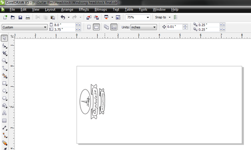

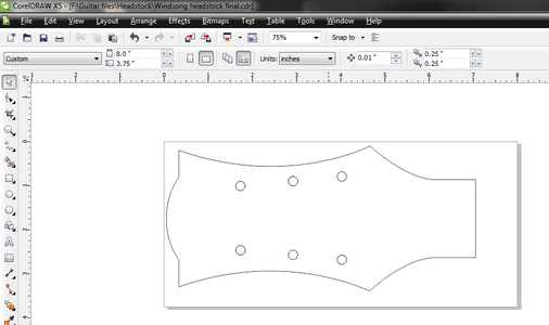

- I converted all my lines to 0.25 line weight (hairline in CorelDraw) to make the laser cutter use vector cut mode instead of raster etching

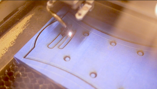

I laser cut the headstock in two different vector passes. The first pass cut through the wood, and the second pass was at a higher speed, cutting ~1/2 way through the wood. My settings are for a ~1/8" piece of cocobolo - other species and sizes may require different settings.
Power: 90%
Frequency: 500
Power: 90%
Frequency: 500
In addition to cutting my headstock, I made a test strip using some scrap wood. The test strip includes 6 copies of the logo, allowing me to test different inlay colors.

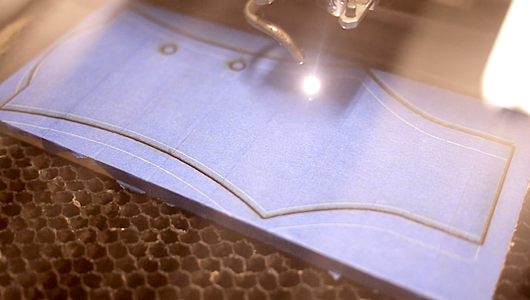

- Wrap the head-plate with painter's tape. This will protect the surrounding wood from charring, and more importantly will create a mask allowing the liquid inlay into the cuts without covering the rest of the wood.
- Focus the laser
- Do an air-pass with the lid open and the red laser pointer on to make sure everything is aligned properly
Pocket settings
Speed: 35%Power: 90%
Frequency: 500
Cutout & tuner holes
Speed: 20%Power: 90%
Frequency: 500
