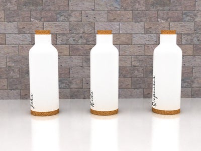

Step 2: The Plan
The basic idea is to allow an exchange of cash ("liquidity") between people. Particularly among people of the same family.
The system consists of two bottles equipped with sensors that can display the bank credit and transfer it through a gesture. Selecting the level of money to be transferred through a touch interface you can transfer the money by placing them in another bottle.
Through a series of LEDs is possible to see how much credit transfer from one bottle to another.

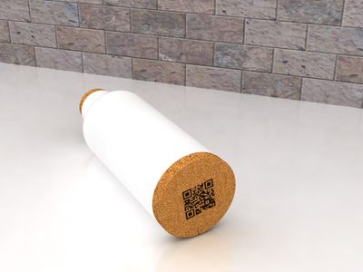

To attach the bottle to your virtual wallet or your bank account using a QRcode place under the base. Application development officer at the association with the credit will be developed in the future. :)
