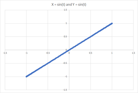

Assume two sinusoudal waveforms of the same amplitude, phase and frequency one assigned to the x axis and one to the y axis these representing our two tuning forks.
X = cos(t) and Y = sin(t) as we can consider the period of a sinewave in relation to the circumference of a circle.
With one revolution equal to 2Pi radians or 360 degrees, sin(t) will range from -1 to +1.
Plotted on an X-Y chart will produce a straight line with an angle of 45 degrees.
If the phase difference is 180 degrees than the straight line displayed will be at 135 degrees.

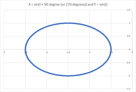

If we change the phase of one of the waveforms by 90 degrees.
X = sin(t + 90 degree (or 270 degrees)) and Y = sin(t), if (sin(t+90 degrees) = cos(t) then X = cos(t)
Plotted on an X-Y chart will produce a circle.

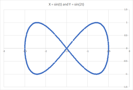

If we vary the frequency of one waveform with respect to a fixed reference frequency the resulting Lissajous figure will display multiple curves. Each curve related to the ratio of the varying frequency to the reference.
Twice the frequency will display 2 loops.
