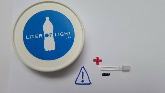

Step 9: Let There Be LIGHT !!
Pay attention here.....LEDs have a (+) and a (-) wire
Long wire = (+)
Short wire = (-)
