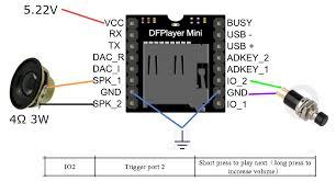

  5. DFPlayer $9 Amazon

There are four main components of this machine: the microcontroller, the RTC, the GPIO expander and the MP3 player. The AW 9523 expands the number of LED controlled PWM outputs you can have from these limited number of GPIO outputs from the tiny Xiao board. It communicates over I2C along with the RTC. The ports that it opens to control the LED filaments are sunk ground connections so all of your anode filament connections are common and you individually call the grounds to control them from the AW board. So in the fritzing diagram above the basic connection for the two boards (AW and RTC) are the four wires for the I2C (3V, GND, D4, D5). There is an additional alarm wire from the RTC to the Xiao (D3) and a wire to control the MP3 (D1) through the transistor. The transistor is used to control the large amount of power used by the MP3 player to play the song. It has its own connections to the speaker and the power directly from the battery(can't be supplied by the Xiao...). The lipo battery is connected to the main switch and then to the battery connections on the back of the Xiao. It provides charging through the USB-C connection on the Xiao. The battery for the RTC can be replaced with a direct connection to the large lipo battery for back-up, but make sure you take out the coin cell if you do this. The wiring for the AW for the filaments looks complicated but it is just a single numbered black wire to the cathode of each filament. The filaments are numbered 0 through 8 and then 9 is used for the red filament which is additional for the Shamash. The TIP 120 transistor is connected to the Xiao with a 2.2 k ohm resistor through the base (pin 1) to D1 and pin2 is connected to ground of the MP3 player (see wiring diagram of MP3 player) and pin3 is connected to ground.
