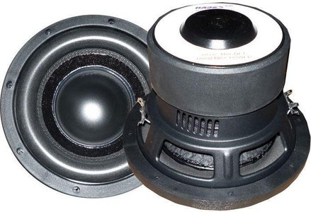

- Subwoofer:Q338A
Power: 250W AES / 500W peak
Frequency range: 35 Hz – 2.2 kHz
Sensitivity: 82 dB/W/m
Impedance (dual coil): 2; 8 Ohm
Price: 38 Eur
Link: https://www.hadex.cz/q338a-repro-203mm---8-subbaso...

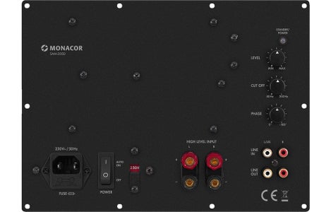

- Amplifier: Monacor SAM-300D
Power output: 300W at 4 Ohms, 150W at 8 Ohms
Variable low-pass filter: 40-200 Hz (18 dB)
Integrated bass boost of approx. 3 dB at 40 Hz
Price: 150 Eur
Link: https://www.soundimports.eu/en/monacor-sam-300d.ht...

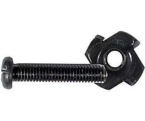

- Bolts with nuts:
8x M5x25 bolts with self-tapping nuts
Link: https://www.hadex.cz/q692-sroub-m5x25mm-cerny-se-s...

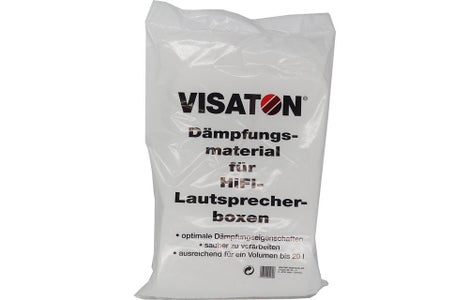

- Dampening material:
Link: https://www.soundimports.eu/en/visaton-damping-mat...

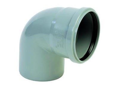

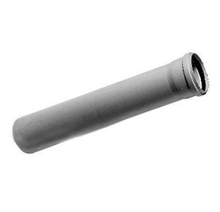

- Port tube:
1x 1m DN75 PVC tube, 1x DN75 87° PVC elbow

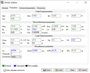

Using free software WinISD for the second time in my life I predicted the behavior of this speaker. This program is quite easy to use and there are many nice tutorials on how to use it. I will therefore not go into much detail.
First I needed to enter all the speaker parameters, so the software can do its magic and calculate the best bass reflex enclosure with all the important dimensions.
In the second picture you can see the simulated frequency response of the speaker. With a little bit of experimenting a decided to use 21l cabinet with tuning frequency of 30 Hz. The cabinet is a little bit bigger than the recommended one on the website which supplies the speaker. That is because of the enormous length of port which would be 680 mm. By increasing the box volume to 21 l the port shrinks to 575 mm which seemed more reasonable for me (see third picture). Final length of my port is about 520 mm but the 90 degree bent in port should result in tuning the port lower.
The third picture shows simulated port air velocity. The peak should not exceed 20 on the y scale of the graph. You need to fill in the important values in signal row first thought.
I must say that this software seems to be calculating quite truthful results. Using only my ears and signal generator, I would say, that this subwoofer can easily play down to 28 Hz, with a little noticeable peak at 32 Hz. The only problem is chuffing of the port at 26 Hz, which I do not know how to get rid of. Using dampening material inside speaker helped, but it did not disappeared completely. Although playing that frequency while not being right in front of the speaker results in hearing more of rattling of different stuff around the house, rather than the port noise.

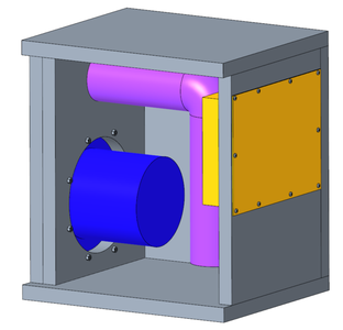

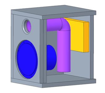

For better visualization of the dimensions I used Creo 4.0 as my 3D modelling program. Using this software, I modelled simplified version of the subwoofer, port, amplifier. Then added all the necessary wooden plates to make the enclosure. Because I had access to 23 mm thick MDF boards, I modelled it to this dimension. If you are going to use wood with different thickness you need to modify some dimensions.
You also need to add to the overall volume of the box all of the components inside. My box has inside volume of 27,7l, but with all of the components inside it is just slightly above 21l.
For anyone interested I included .STP file of the Creo assembly as well as .PDF file with drawings and all of the dimensions. It is all in Czech, but I think it is all quite self-explanatory with this instructable. (dimensions are in mm)

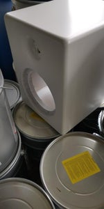

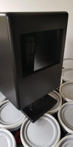

For the colouring I decided to use matte black paint - daring right? This entire step was done by my father, who works with colours for wood for more than 20 years, so I had confidence in the outcome. However, oblivion or miscommunication resulted in him standing the speaker upside down on his colouring platform (picture 2). Which led to markings on the bottom/top side. But because it doesn't matter at all, I went with this orientation instead.
First 2 layers of paint consisted of clear lacquer. This step ensures the sealing of the MDF fibers. It roughens the surface as the MDF fibers rises, therefore sanding is required. The next layer of paint is white adhesive base layer followed up by two final black layers. With sanding in between of all of the layers. It is also important to have the port attached, so that its inside doesn't stay grey, but is rather painted black.
In total he used 1l of clear lacquer, and the final mass of this speaker increased by almost 400g after all the paint dried.
It is incredibly difficult to produce painted surface with no impurities, because every speck of dust is visible, but my father didn't let me down as always and made this piece of ugly wooden cube into a design masterpiece.
Then I just inserted the amplifier and secured it with screws to predrilled holes. The subwoofer is then connected to the speaker wires from the amplifier and bolted down thanks to the self-tapping nuts, that ensures longer life for the speaker mounting.

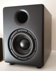

The speaker can play down to 28Hz without problem and even with a bit weaker amplifier (speaker coils are in series, therefore 8 Ohms total impedance) can be very loud.
In conclusion I am very happy with the outcome. The main surprise was watching action movies with it and hearing all those frequencies shaking the whole house. In the future I plan to try to turn it up more to see what it is really capable of, but because of shared living, it is not possible at the moment.
