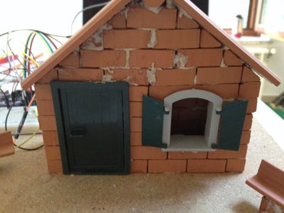

I created a house with a light that graually turn on a light if it is dark and an alarm connected to the door the squeeze and send email if someone enter the house!

Link a bulb lamp to a transistor and the transistor with one of your arduino's pin..
Create a circuit with a 2K resistence and a fotoresistence, this is useful to read the voltage in the connection of two resistence..
Done..! The lamp turns on in the dark!
I did analogRead from fotoresistence and then analogWrite to transistor!
Step 3: Set the Alarm
Download Blynk app! (http://www.blynk.cc/)
Create a circuit with a push button, and a contact sensor for the door: when the door is closed digitalRead(button) should be 0!
Create an email widget on the app!
It's done!
My code sends an email when the door's open!
