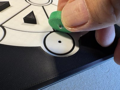

Step 2: Installing Magnets
For this step you'll need
  1. 15 small magnets (Ø 3 x 2 mm)
  2. super glue
  3. screwdriver (or another tool that can be used to push the magnets into the holes)
The magnets are neodymium MIni magnets, Ø 3 × 2mm. To prevent the magnets of the playing field and the game pieces from touching directly and thus sticking to each other, the magnets need to be positioned in such a way that this is prevented. This is why the magnets are embedded deeper.
To ensure that the magnets have a tight fit, the holes are intentionally narrow with a diameter of 3.1 mm. However, this means that inserting the magnets requires skill and a little force.
When inserting the magnets, make sure that the poles are aligned in the same direction!

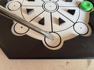

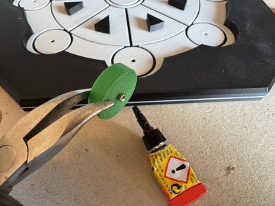

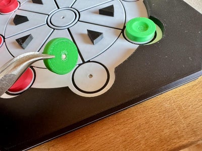

I proceeded as follows: I took a token and pressed a magnet into it. A little superglue ensures that the magnet cannot be pulled out.
Now I took another magnet and let it be attracted by the magnet I had just inserted. Again a little bit of superglue ... and now i placed the game piece with the magnet attached over a hole in the game board and pressed the magnet into it. I used a screwdriver to push the magnet in deeper. I did the same with the other holes.
This work is a bit fiddly! If you want to be sure that the magnets “slide” into the holes, you should break the edges of the holes a little.

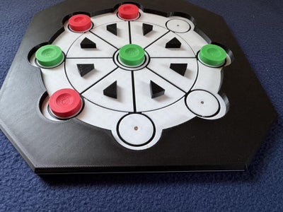

Step 3: How to Play
The game does not start - as in the traditional mill game - by alternately placing the tiles, but by placing the tiles as shown in the cover picture.
A stone can be played in all directions, including on the circular path. The winner is the first player to make a “mill”. A mill only ever goes over the center point!
