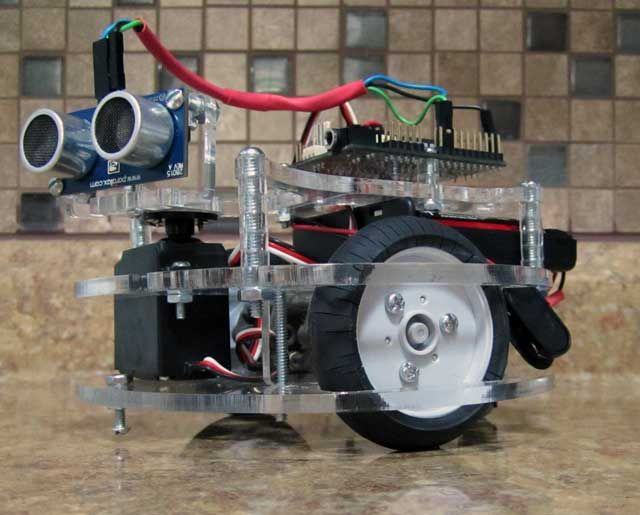

Neat little laser cut tank design, a companion to this instructable. Made in response to the poorly made offerings on the market, and a general need for a ready to go, easily adaptable tracked platform. Uses a Tamiya 70097 motor/gearbox combo and a Tamiya 70100 track and wheel mechanical kit.
Easily adaptable to a wide range of battery, sensing and microcontoler combinations. Use A standard or micro servo (adapter plate included in cut file), standard servo recommended. Parallax Ping mounted on the ranging mast; SRF05, 05 or multiple IR ranging solutions will fit as is.
Deck height is adjustable to accommodate just about battery arrangement, including lipo (with a regulator).
Cut files provided in CDR and DXP format, or get www.ponoko.com to cut them for you if you'd prefer not to cut your own.
Cut files are sized for 4mm acrylic material - if you use a different material thickness, be sure to resize the file for a good fit. Easily adaptable for CNC , just create an offset and machine away.

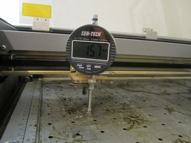

Step 1: Cut Your Parts!
Settings for a Epilog helix - Bottom up engraving, 300DPI; raster = 57 speed, 100 power; vector = 8 or 9 speed, 100 power, 5000 freq.

Step 5: Top Deck / Electronics Deck
You'll need 2 .75 4-40 screws + nuts for the top deck and 2 .75 4-40 screws + nuts and 4 spacers for the electronics board + microcontroler.
Step 6: Sides / Tamiya 70097 Motor Gearbox / Assembly
You'll need the Tamiya 70097 + 2 sides to create this assembly.
Step 7: Complete Frame / Electronics Deck / Servo
You'll need the previous assembly, plus the top and lower deck for this assemble.  Use qty 10 .75 4-40 screws + nuts to complete this step.
you'll need qty 4 4-40 nuts to attach the electronics deck to the main frame.
you'll need qty 2 .5 4-40 screws + nuts to attach the servo. - also, attach the servo BEFORE attaching the top deck...

    I found the only really good place for a battery pack was the lower deck, underneath the servo. This only works with a mini servo, as the standard servo gets in the way. I used a 3xAA battery holder, and it fits just fine.
    I may use the new-ish 1.6V NiZn rechargeable batteries with this robot. They start fully charged at 1.8V, so they should last a while.

    I ran into some trouble on this step. You have to assemble the parts in the right order, or you'll wind up taking it apart and re-doing it.
    I suggest the following order:
    1) Attach the left side to the bottom deck.
    2) Put the left motor shaft through the left side.
    3) Slide the right side over the right motor shaft and attach to the bottom deck.
    4) Attach the servo to the top deck.
    5) Put the top deck in place, and attach the motor first, then the deck screws.
