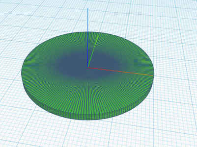

Step 2: A Regular Polygon As a Sum of Triangles
A regular polygon with x number of sides can be geometrically divided into an x number of isosceles triangles. Ie: In the first image you can see that a pentagon can be divided into 5 triangles, an hexagon into 6 and so on and so on. So when we can create a polygon using isosceles triangles.
That is what we are going to use in Codeblocks, by scaling roofs into specific isosceles triangles, we can create a regular polygon.
In image #2, we can see that:
1) The angle beta at the top of the triangle can be calculated by dividing 360 degrees by the number of sides of the polygon. ------> Beta = 360 / (number of sides)
2) The alpha angles are equal and can be calculated by subtracting beta to 180 and dividing by two, since all of the angles inside a triangle add to 180. -------> Alpha = ( 180 - Beta ) / 2
3) The side a is always equal to the radius of the circumference. -------> a = radius.
4) The height of the triangle h can be found using trigonometry with the sine of Alpha. ------> h = a * sin ( Alpha ).
5) The side b can be calculated using trigonometry with the cosine of Alpha. --------> b = 2 * a * cos ( Alpha ).
Step 3: Working With Codeblocks
The closest figure to a triangle in Codeblocks is a roof (Image 1). This roof has the following default dimensions: 20 mm lenght, 20 mm width and 10 mm the height. We have to take these proportions into account to accurately modify our roof. So this algorithm will be about modifying that roof.
First, we have to create a variable and that is the number of sides of the desired polygon. (Image 2).
Next we have insert a roof and modify it to be the isosceles triangle that we need. So we use the create object block and name it "triangle". after that we have to add a roof with a length of 2. (image 3).
Now we have to scale it. to the desired height and width. So we need the correct proportions. For the height we use the sine of Alpha (Z axis) and for the width we use the cosine of Alpha (X axis).
Next we rotate it 90 degrees to make it flat with the XY plane.
And last, since we are going to rotate it using the center of the workplane as pivot we have to displace it half of the height in the Y axis. (Image 4).
With the triangle done, is a matter creating a new object called " polygon" of adding copies and rotating them using a loop and the "sides" variable. (Image 5).
Step 4: Create Any Polygon.
Now you just have to run the algorithm and change the number of sides and as you increase this number you will get a better approximation of a circle. For a better view you can use the group block to see how a circle emerges in front of your eyes.
