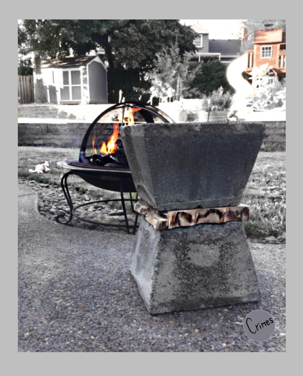

The pier blocks here were 11"x 11"x 7.5". These blocks weigh about 40 pounds each and have a hole in the middle for a post or pipe. The live edge wood scraps were from a pervious wine closet project, but any weather resistant wood stacked at 2" will work great. I was going to bolt down some flat iron but rebar was used as a last minute change for stability.

- Begin by placing the tapered end of the concrete block on the wood slab.
- Then use a pencil to draw out your design so it protrudes beyond the concrete edge for an aesthetic effect.
- Next use a jig saw with a rough cut blade (good for thick material) and then follow the pattern that you drew around the wood slab.

-Place the rebar in the base hole of your first pier block. Then put your slab through the rebar, snugging down on the base block.
-Next flip the second pier block, small side down and line up your hole and set it onto the rebar. You now have an 80 pound seat that is...well, pretty rock solid.
-Use the angle grinder with an 80 grit flap disk to shape the slab and smooth out any rough edges.
-Finally using the same flap disk on the angle grinder smooth out the concrete seat and edges. This surprisingly polished it just enough to be smooth to the touch without using a fancy diamond paste.
Step 5: Set Up and Enjoy
I made these so they can be taken apart and moved, they are very stable without glue or screws. These seats sit at a standard stool height of 17 inches.
