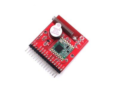

This gateway is composed of an ESP32S3 4G LTE A7670 module and a LoRa radio expansion
Note: LoRa communication needs the sender& receiver to work at the same frequency. The frequency of the LoRa Soil Moisture Sensor is 915MHz, so the frequency of the LoRa Expansion Board needs to be 915MHz as well.
Step 1: Hardware
  • Connect the pins of both boards as indicated in the photo above
  • Insert the SIM card into the slot on the back of the ESP32S3 based 4G LTE module
