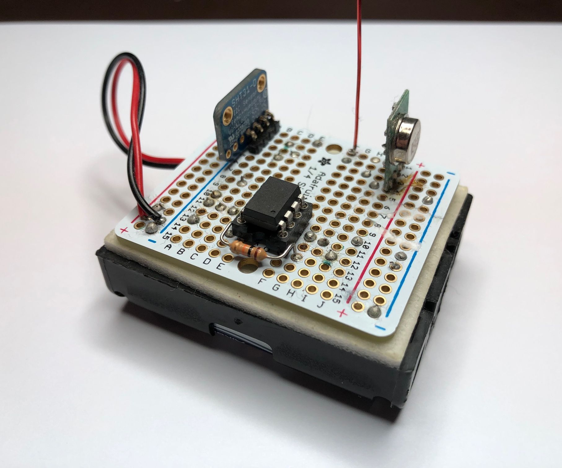

Step 2: Indoor Station Hardware
Parts List for one Indoor Station:
1 x Feather 32u4 RFM95 LoRa Radio - 868- or 915-MHz, Adafruit PID 3078
1 x Female Stacking Headers - 12-pin and 16-pin, Adafruit PID 2830
1 x FeatherWing prototyping board, Adafruit PID 2884
1 x SHT31-D temperature & humidity sensor breakout, Adafruit PID 2857
1 x Four pin female pin header
1 x USB cable A / MicroB, 3 ft, Adafruit PID 592
1 x 5V 1A USB port power supply, Adafruit PID 501
3 inches 22 AWG enamel wire
Misc hookup wire
Refer to the Adafruit website for detailed information on the following steps:
- Soldering the stacking headers and wire antenna to the Feather 32u4 RFM95 LoRa Radio.
- Soldering the included male pin headers to the SHT31-D.
- Soldering the included male pin headers to the FeatherWing prototyping board.
Solder the four pin female header to the FeatherWing prototyping board according to the picture above so the SHT31-D VIN and GND pins are connected to the 3.3V and GND rails, respectively, on the FeatherWing prototyping board.
Use the hookup wire to make the following connections on the underside of the prototyping board:
FeatherWing <--> SHT31-D
SDA <--> SDA
SCL <--> SCL
The SDA and SCL pins are designated on the prototyping board and are in the top right corner of the prototyping board in the picture above.
Plug the prototyping board into the stacking headers on the Feather board.
Program the Feather boards with Indoor Station software. When deployed and powered via the USB cable connected to USB power supply, the Indoor Stations should start sending reports to the LoRa IOT Gateway every ten minutes.
That's it for the Indoor Stations.

- Reference Adafruit assembly instructions for soldering male pin headers to the BME280 breakout board.
- Using the photo above as a guide, solder a set of four-way right-angle male pin headers to the Adafruit Perma-Proto Half-sized Breadboard PCB.
- Using the photo above as a guide, solder the BME280 breakout board to the prototyping board.
- Using wire jumpers, make connections between the BME280 breakout board VIN, GND, SCK and SDI pins to the four-way right-angled male pin header installed in step 3. These pins connections must match connections on the BME280 pin header on the FeatherWing Doubler board as follows: 3V = VIN, GND = GND, SDA = SDI and SCL = SCK.
- It just so happens that the mounting holes on the Adafruit Perma-Proto Half-sized Breadboard PCB match exactly the sensor mounting holes on the solar radiation shield. Mount the prototyping board to the solar radiation shield using the screw hardware supplied.
- Plug the four-conductor cable for the BME280 from the Feather prototyping board into the male pin headers on the prototyping board in the solar radiation shield.
- There is a row of unused female pin headers shown in the photo above. These were used during early experiments to select sensors for the outdoor station, and are not required for normal operation.

Step 9: Indoor Station Software
The LoRa Indoor Station software is written in a procedural style and liberally commented to encourage enhancements and reuse. The software is published here on Github and is also attached below. Highlights of the software are provided in this step, however, a detailed understanding of the software implementation is best accomplished by reviewing the code and comments.
The indoor stations and outdoor station are collectively referred to as remote stations.
Each remote station requires a unique ID number to be correctly identified by the LoRa IOT Gateway. The ID number is hard coded in the current software, therefore, the remote station software must be recompiled with a unique remote station ID for each remote station. The software currently limits the maximum number of stations to ten, so the station IDs should begin at 0x00 and end with 0x09. In a future software version this will be handled automatically between the gateway and the remote stations, allowing the system to be plug and play.
Adafruit libraries are used for initializing and reading temperature and humidity values from the SHT31 sensor.
Remote stations send up to five floating point values to the gateway as shown in the code snippet below.
typedef union {
float floatingPoint;
byte binary[sizeof(floatingPoint)];
} binaryFloat;
binaryFloat airTemp;
binaryFloat gndTemp;
binaryFloat humidity;
binaryFloat pressure;
binaryFloat batVolt;The union maps floating point values to bytes allowing the floating point values to be sent across the wireless link as bytes. Other variables such as int and long can be sent in the same way. The number of variables sent over the wireless link can be increased by defining new variables as above, and adding the variables to the wireless packet described below.
The indoor stations send air temperature (airTemp), humidity, and battery voltage (batVolt). The battery voltage in the case of indoor stations is the power supply voltage to the Feather board. The indoor stations set the ground temperature (gndTemp) and pressure values to zero.
The size of packet sent over the wireless link is determined as 5 floats x 4 bytes per float + 1 byte for remote station ID = 21 bytes. The wireless packet is built up in the buildWirelesspacket() function using the binary mapping of the floating point variables as follows.
for(int n=0; n<4; n++) {
wirelessPacket[n] = airTemp.binary[n];
wirelessPacket[n+4] = gndTemp.binary[n];
wirelessPacket[n+8] = humidity.binary[n];
wirelessPacket[n+12] = pressure.binary[n];
wirelessPacket[n+16] = batVolt.binary[n];
wirelessPacket[20] = stationID;This process is reversed in the gateway software to extract the bytes from the wireless packet and map them back into the corresponding floating point value.
The following code is used to enable Watch Dog Timer (WDT) sleep mode and set the prescaler to its maximum value which causes the WDT to wake up the processor every ~8 seconds.
set_sleep_mode(SLEEP_MODE_PWR_DOWN);<br>MCUSR &= ~(1 << WDRF); WDTCSR |= (1 << WDCE) | (1 << WDE); WDTCSR = (1<< WDP0) | (1 << WDP3); WDTCSR |= (1 << WDIE); sleep_enable();
When the WDT wakes up the processor, the Interrup Service Routine (ISR) increments a variable stateTime to count 8 second increments of time, and the loop() function is executed once, finally putting the processor back in sleep mode. The loop() function is a time-based event loop that causes sensor readings to be taken and sent to the gateway every ten minutes.
The LoRa Radio is put in sleep mode in between sending wireless packets to gateway.
The rest of the indoor station code should be self explanatory. That's it for the Indoor Station software.
