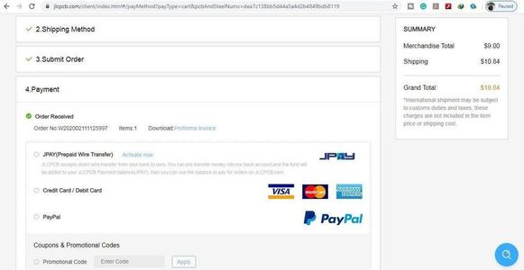

Step 6: Select Shipping Address and Payment Mode
  1. Type the Shipping Address.
  2. Select the Shipping Method suitable for you.
  3. Submit the order and proceed with the payment.
You can also track your order from the JLCPCB. My PCBs took 3 days to get manufactured and arrived within a week using the DHL delivery option.
