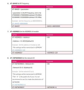

Step 3: Configuring the Parameters With AT Commands
First, you have to connect the LoRa module with FTDI232 USB to serial interface board as per the circuit to configure some parameters with AT commands.
In Serial monitor select the Baud rate = 115200 and "Both NL & CR".
AT Commands used for the Transmitter LoRa module
  • AT+ADDRESS=1
  • AT+NETWORKID=5
  • AT+BAND=865000000
AT Commands used for the Receiver LoRa module
  • AT+ADDRESS=1
  • AT+NETWORKID=5
  • AT+BAND=865000000
Select the BAND as per the eligible LoRa bands available in your country.
Please refer to the tutorial video for more details.

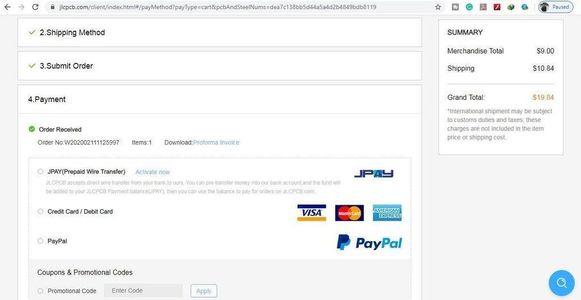

Step 8: Select Shipping Address and Payment Mode
6. Type the Shipping Address.
7. Select the Shipping Method suitable for you.
8. Submit the order and proceed with thepayment. You can also track your order from JLCPCB.com.
My PCBs took 2 days to get manufactured and arrived within a week using the DHL delivery option.
