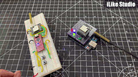

Step 4: Circuit Diagram:
The circuit diagram is same for the Lora connection. MOSI to D11, MISO to D12, SCK to D13, D10 for NSS and D9 for the Reset. but there are modifications done on switching side. In the transmitter section two tactile buttons are connected to D3 and D4 pin of the Arduino. Buttons are work in hold state only. The output at receiver end goes ON/OFF by pressing/releasing tactile button respectively.
On the receiver end we are using a string receiver LED on pin D3, which gives the information about connection. This LED will blink after every second and gives the information about the successful connection of LoRa RF signal. We are using D4 and D5 as the output, by default these pins are hold high and go to low as the button pressed from the transmitter. This type of code is done for the Relay based application of the LoRa.
Step 5: PCB Shield and Prototype:
I made a prototype for the transmitter but a dedicated PCB is recommended for it. I am using Pcbway service- China based PCB manufacturer. These hole type pref board I got from PCBWAY but you can download the dedicated PCB shield files from here.
There are a lot of connections in the PCB that why shield is recommended to use. Get the PCB in just $5 for 5 pcs of 2layer board. Register now to PCBWAY and get free rewards as coupons. There is some limitation in holed type design because they are made to try different projects. And soldering wires properly through them is not an easy job. Get a full soldering guide soon here.

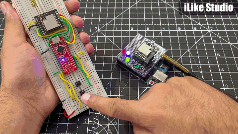

Step 8: Working and Demonstration:
The receiver is made on a PCB shield and for transmitter I am using a breadboard. 5-volt battery/ power supply is enough for proper working. After turning power On, the red LED start as the connection indicator. And we are using two more Green and blue LED to examine the output.
After pressing the button on transmitter, the respective LED is turn OFF, a small delay of 0.5 seconds is there because the system is working on a low frequency. The receiver and transmitter are working very fine you can use this type of trans receiver system with Relays for heavy AC loads.
Sometimes there is problem in establishing the connection because of helical wire antenna. A SMA type antenna with 3dB gain can be used to extend the range up to 10 km. In this case a reset is required from the transmitter for the reconnection.
