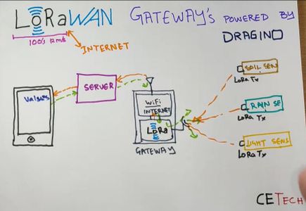

Step 2: What Is LoRa WAN?

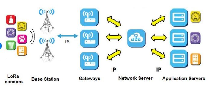

The LoRaWAN specification is a Low Power, Wide Area (LPWA) networking protocol designed to wirelessly connect battery operated ‘things’ to the internet in regional, national, or global networks, and targets key Internet of Things (IoT) requirements such as bi-directional communication, end-to-end security, mobility and localization services.
LoRaWAN network architecture is deployed in a star-of-stars topology in which gateways relay messages between end-devices and a central network server. The gateways are connected to the network server via standard IP connections and act as a transparent bridge, simply converting RF packets to IP packets and vice versa. The wireless communication takes advantage of the Long Range characteristics of the LoRaÒ physical layer, allowing a single-hop link between the end-device and one or many gateways. All modes are capable of bi-directional communication, and there is support for multicast addressing groups to make efficient use of spectrum during tasks such as Firmware Over-The-Air (FOTA) upgrades or other mass distribution messages.

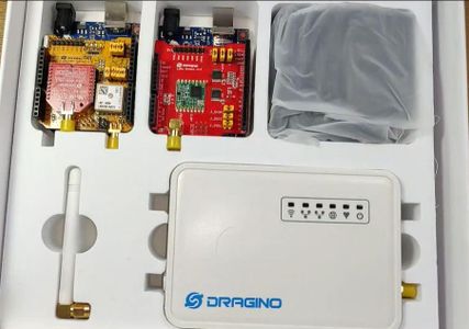

Step 3: The Dragino IoT Kit
The Dragino IoT Kit is a well-designed kit to facilitate beginners and developers to quickly learn LoRa and IoT Technology. With the help of this kit, you can make a lot of LoRa based project and also learn about the IoT applications of LoRa. This kit comes in two versions V1 and V2. We are using the V2 kit in our project as it is the latest one. This Kit comes with the following items in it:
  • 1 x LG01-N Single Channel LoRa Gateway
  • 1 x (LoRa Shield + Arduino UNO)1 x (LoRa/GPS Shield + Arduino UNO)
  • 1 x flame sensor
  • 1 x Relay
  • 1 x photosensitive sensor
  • 1 x Buzzer
  • 1 x Ultrasonic Sensor
  • 1 x DHT11 Temperature and Humidity Sensor
  • 10 x DuPont wire (male to male)
  • 10 x DuPont wire (female to female)
  • 10 x DuPont wire (female to male)
With all these tools you can build a number of projects based on LoRaWAN and can equip them for IoT applications.

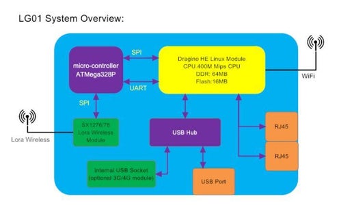

Step 4: About Dragino LG01-P IoT Gateway Featuring LoRa Technology
Dragino offers a range of LoRa WAN Gateways which are meant for different purposes but the one we are going to use here is the LG01-P IoT Gateway featuring LoRa Technology.
It is an open-source single channel LoRa Gateway. It lets you bridge LoRa wireless network to an IP network via WiFi, Ethernet, Or 3G/4G cellular via optional LTE module. TheLoRa wireless allows users to send data and reach extremely long ranges at low data-rates. It provides ultra-long range spread spectrum communication and high interference immunity. LG01-P offers a number of internet connection methods such as WiFi interface, Ethernet port, and USB host port. These Interfaces provide flexible methods for users to connect their sensor networks to the Internet. It can support limited LoRaWAN protocol in single frequency and customized LoRa transmit protocol.
Some of the main features of this gateway are that It consumes Low Power, has a built-in webserver, has a failsafe design providing a robust system, is compatible with Arduino IDE, etc. It also supports WiFiAP, Client, or Ad-Hoc(Mesh) mode.

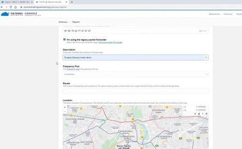

8) Now open TheThingsNetwork console and hit the Gateways button. Here we need to register a new network for that click the Register Network button. This will open the Register Network page on that page select the Legacy Packet forwarder option.
9) After that head back to the dragino page. On that page go to the services tab and under that select the LoRaWAN Gateway option. A webpage will open up on that page there will be a Gateway ID present. Copy that Gateway ID and paste that in the Gateway EUI option on the ThingsNetwork console page.
10) After that enter any description in the description block on the ThingsNetwork console page, Select the frequency Plan(In my case, It is INDIA), Select the location on the map where your gateway is present, select the Antenna Placement option(In my case, It was Indoor) and then click the register gateway button.
11) This will register the network and that can be verified by looking at the status which should say "Connected".

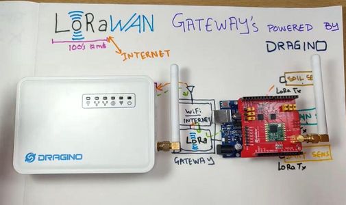

Step 8: Testing the New Gateway Link
Before uploading the code when we see the TheThingsNetwork console page. We observe that there is a status field that says "never seen" but as soon as we upload the code the Arduino gets connected to the Gateway through LoRa and the status changes to just now and after that, it changes to 1 second ago, 2 seconds ago and so on. This shows that the Arduino is sending data and it is successfully received at the Server end.
Talking about the code. It is designed in such a manner that it continuously sends random numbers to the server the number received can be seen on the server-side by going to the Data tab on the console page where the received data is visible. We can also see the data sent by the Arduino on the Serial Monitor to cross-check that the numbers are transmitted correctly.
In this way, We used the Dragino LG01-P IoT gateway to create a LoRaWAN and successfully transmitted data over that. Hope you liked the project.
