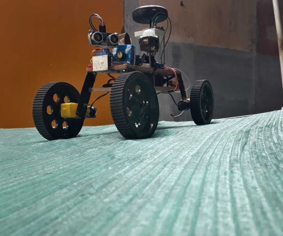

for a few weeks, I have been working with Twilio’s API, especially for WhatsApp messaging, and even created a project sending the variables coming from NodeMCU to my phone.But, my former project was merely sending data packets to my phone as WhatsApp messages periodically. And, I was determined to take my nascent idea and improve it by using WhatsApp response messages and a MySQL database and thus created this project. In that way, NodeMCU transfers variables to the phone as WhatsApp messages when the user requested them or gets commands from the user through WhatsApp. To manage that, I created a web application in PHP, which detects whether a WhatsApp message was sent or not and response the message depending on the keyword in the body. The application, named WhatsApp Two-Way Connection Hub, saves all variables transferred from NodeMCU and commands received from WhatsApp to a dedicated MySQL database and therefore communicates the user and NodeMCU instantly when something requested. I shared the source code of the application below if you want to use the localhost or your server instead of TheAmplituhedron to create a connection hub, but first, you have to download Twilio Helper Library in your directory.In this project, I wanted to make a remote mapping and weather forecast bot sending temperature, pressure, altitude, latitude, and longitude when requested as WhatsApp response messages and control the base by giving commands through WhatsApp. To gather data, I decided to use a BMP180 Pressure and Temperature Sensor, and a GY-NEO6MV2 GPS Module and to make the base remote and controllable, I used an L298N Motor Driver and two Wheel and DC Motor Kit along with a ball caster.

- Collect date, time, latitude, and longitude information generated by a GY-NEO6MV2 GPS Module.
- Get temperature, pressure, and altitude from a BMP180 Pressure Sensor.
- Make an HTTP Get Request to transfer variables to the database and receive the command from the database as a response.
- Depending on the command, control an L298N Motor Driver.
- Monitor all processes on the serial monitor.
- Elicit response messages to display variables saved to the database as requested through WhatsApp or give commands to the device by sending the command on WhatsApp.
