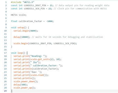

Step 3: Run Code
  1. Run code below
  2. Go to tools, click Serial Monitor (ctrl + shift + m), set the baud to 4800 and view results.
#include "HX711.h"
const int LOADCELL_DOUT_PIN = 21; // Data output pin for reading weight data
const int LOADCELL_SCK_PIN = 22; // Clock pin for communication with HX711
HX711 scale;
float calibration_factor = -1000;
void setup() {
 serial.begin(4800);
 delay(10000); // Waits for 10 seconds for debugging and stabilization
 scale.begin(LOADCELL_DOUT_PIN, LOADCELL_SCK_PIN);
void loop() {
 serial.print("Reading: ");
 serial.print(scale.get_units(2), 10);
 serial.print(" lbs");
 serial.print(" calibration_factor: ");
 serial.println(calibration_factor);
 serial.print('Raw: ');
 serial.print(scale.read());
 serial.println();
 scale.power_down();
 delay(500);
 scale.power_up();
