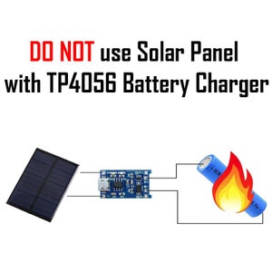

Hi! Today I will show you why you should not use a solar panel directly with TP4056 Li-Ion battery charger, and how you can use solar panel with TP4056 Li-Ion battery charger.
The problem - I wanted to use a float sensor to measure the level of water in my overhead tank. It has three wires coming out of it. It is basically a single pole double throw switch, which is controlled by the metal ball inside the sensor. The gravity pulls the metal ball up and down depending on the height on which sensor is floating and its counterweight. So, I wanted to make a circuit with LED to show low water level, buzzer to show high water level, a salvaged Li-Ion cell for power along with a boost converter and TP4056 charger. Originally, I planned to charge the Li-Ion cell with a 6V solar panel, but quickly realized the problem with it. The LED/buzzer will continue to draw current if the connection is not broken which would mean the TP4056 will not realize that the battery is full and continue to feed power to it. This can lead to overcharging of Li-Ion cell and in a worst-case scenario the battery can blow up. To avoid this, we can add a switch to cut off the power when battery is charging but that would require a manual intervention which in my case was not possible. The solution is to still add a switch, but in this case, it will be an automatic switch and will cut the power to the load whenever charger is connected and as an awesome bonus, will feed the load with its own power. Let’s see how we can achieve that.

The solution, or rather the switching circuit is called load sharing and contains 3 components, a P-channel MOSFET, a Schottky diode and a pull-down resistor. Let’s understand its working. When charger is not connected, the gate of the MOSFET is pulled low, that means it is in conducting state and that means the load is connected to the output of TP4056 board. On the other hand, when the charger is turned on, the current chooses the lower resistance path to travel and hence the gate is pulled high, which means the MOSFET in not conducting anymore, disconnecting the load from TP4056. The diode is to make sure that current doesn’t flow from the battery to the charger when the MOSFET is conducting. Now that we understand the circuit, let’s move on to the next section.
