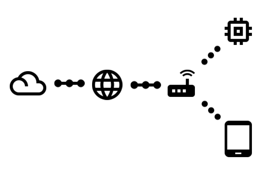

This instructable will tell you how to put most of the UI in the cloud instead of on the Arduino / ESP. Doing it this way will save you on space and memory usage.
A service providing free static webpages is particularly suitable as "cloud", like GitHub Pages, but other options will probably work as well.

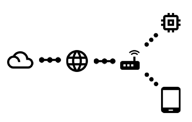

Building up the webpage this way requires the user's browser to go through 4 steps:
- Request the root url from the Arduino / ESP
- Receive a very simple webpage, telling to:
- Request a JavaScript file from the cloud
- Receive the code that builds up the actual page
This Instructable will also explain how to interact with the Arduino / ESP once the page is ready as per the above steps.
