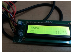

Make an inexpensive and automated DIY WeatherBot .Here we are using SIMCom SIM900A. It’s one of the cheapest Gsm/Gprsmodule available in market. A sensor measures temperature of your room and another temperature reading is taken from openweather.com and post them on thingspeak.comand over LCD screen it displays both the temperature and type of weather on the top.

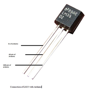

3. Use of internal reference for LM-35 (temperature sensor):
The LM35 is a common TO-92 temperature sensor. It is often used with the equation
temperature = (5.0 * analog-input) * 100.0) / 1024;
However, this does not yield high resolution. This can easily be avoided, however. TheLM35 only produces voltages from 0 to +1V. The ADC uses 5V as the highest possible value. This is wasting 80% of the possible range. If you change aRef to 1.1V, you will get almost the highest resolution possible.

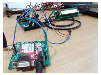

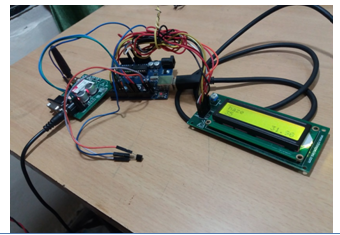

Step 3: Making Hardware Connections

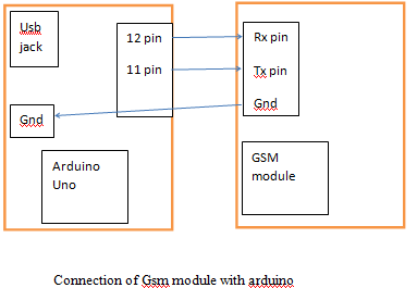

1) Connecting GSM with Arduino
We are using SoftwareSerial library for serial communication with GSM. The connections are shown in above figure .
2) Connecting LCD with Arduino
The connections are shown in above figures
3) Connecting LM-35 with Arduino
