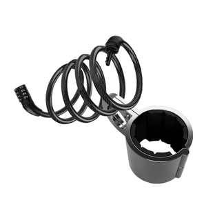

This is my favorite phase of the design process-when you get to practically apply your research and work with your hands! The concept I built was a clamp that fastens around the scooter’s upright bar with a loop to pass a cable lock through, padded with rubber inserts and fastened with anti-theft screws.

The next step was to build a 3D model so I could work out the kinks, determine proper measurements and 3D print a refined model. I used Autodesk Fusion 360, so that I could not only create a good CAD model, but also get some lovely shiny renderings out of the deal.
I won't go through every step of the process, but for this model I started off with an extruded sketch, and used extruded cuts to make the rounded side with the holes. I then split the body in two and filleted all the edges. I built the thinner insert, which is again a simple extruded shape made to the internal diameter of the metal clamp. The thicker inserts (for scooters with smaller bar diameters) are also made to the inner diameter of the clamp, and have v-shaped cuts so they can bend properly. I then used Fusion's fasteners tool to add in two screws to the model.
I applied material finishes to all the parts-anodized aluminum for the metal, and soft touch rubber for the two inserts. I then used the scene setup tools to prepare for rendering, using cool toned lighting to get some good highlights on the metal edges. Fusion renderings tend to turn out very pretty if you set them up right, it usually takes a few tries to get the lighting right on dark objects like the rubber, but it's worth it!

I presented my work for a panel of several professors and design professionals, they gave me some fantastic constructive criticism. The first comment I got was on the name I'd hastily chosen for my presentation, Lock Mate. One of the panelists pointed out that a quick Google search yielded many different products by that name. Whoops, time for a name change. Based on a USPTO trademark search and a google search, Lock Assist was a much better option.
Another panelist pointed out that based on my sequence of use images, it looked like securing the clamp around the scooter would be difficult. I had to hold it shut and hold one of the screws at the same time with one hand, while using the screw driver with my other hand. He suggested some kind of click-together construction that would hold the clamp around the bar while the user's hands would be free to fasten the screws.
Both of these were excellent points that I took note of for the last step in my process.

Secure: Prevents theft, attaches lock to scooter-The Lock Assist attaches a cable lock to the scooter so the user doesn't have to take it off when riding, also assists with correct locking to bike racks and poles.
Specific: Made for scooters, not only a bike lock-The Lock Assist integrates with currently used bike locks, but is made specifically for scooters.
Sturdy: Not easily broken or cut-The Lock Assist would be made from durable anodized aluminum and would be no easier to cut than a cable or U-lock.
Simple: Takes minimal time & effort to use-I think I still have room for improvement on this one. The Lock Assist certainly removes the time of putting the lock on and taking the lock off after every ride and parking, but as a panelist mentioned, the current design requires some difficult one handed screw and clamp holding. By improving the clamp with a click together function, I'd meet this aspect of the criteria.
