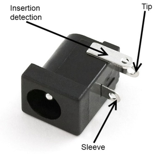

Your wiring might differ from mine, but attached above is a basic outline of my project's wiring. On the very left, there is a rectangle with a Sleeve and Tip. This is a DC barrel jack adaptor. The wiring for this is very specific. If done incorrectly, there will be significant consequences to the Argon (and possibly other attached devices). Do not connect to an additional power source. Your tip should be connected to the power (+) rail, which is also connected to your VUSB pin. The sleeve should be connected to your ground (-) rail, which should also be connected to your GND pin. An AC/DC Power Adapter of 5v output should be attached to your DC barrel jack adaptor. This is how the project will draw its power from a wall that the power adapter is connected to.
Step 6: Resource for DC Barrel Jack Adaptor
For more help understanding how to connect to the pins of the power jack, look at the attached image. Credit: https://learn.sparkfun.com/tutorials/connector-basics/power-connectors
