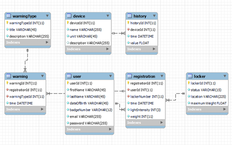

Step 2: Databasestructure
warningType Table
- **warningTypeId (INT)**: A unique identifier for each type of warning.
- **title (VARCHAR(45))**: The title or name of the warning type.
- **description (VARCHAR(255))**: A detailed description of the warning type.
warning Table
- **warningId (INT)**: A unique identifier for each warning record.
- **registrationId (INT)**: A foreign key that links the warning to a specific registration.
- **warningTypeId (INT)**: A foreign key that links the warning to a specific type of warning (warningType).
- **time (DATETIME)**: The date and time when the warning was issued.
device Table
- **deviceId (INT)**: A unique identifier for each device.
- **name (VARCHAR(45))**: The name of the device.
- **unit (VARCHAR(45))**: The unit of measurement for the device's readings.
- **description (VARCHAR(255))**: A detailed description of the device.
history Table
- **historyId (INT)**: A unique identifier for each history record.
- **deviceId (INT)**: A foreign key that links the history record to a specific device.
- **time (DATETIME)**: The date and time when the historical data was recorded.
- **value (FLOAT)**: The recorded value of the device at the specified time.
user Table
- **userId (INT)**: A unique identifier for each user.
- **firstName (VARCHAR(45))**: The first name of the user.
- **lastName (VARCHAR(45))**: The last name of the user.
- **dateOfBirth (VARCHAR(45))**: The date of birth of the user.
- **badgeNumber (VARCHAR(12))**: A unique badge number assigned to the user.
- **email (VARCHAR(255))**: The email address of the user.
- **password (VARCHAR(255))**: The password of the user for authentication purposes.
registration Table
- **registrationId (INT)**: A unique identifier for each registration.
- **userId (INT)**: A foreign key that links the registration to a specific user.
- **lockerNumber (INT)**: The number assigned to a specific locker in the registration.
- **time (DATETIME)**: The date and time of the registration.
- **lightIntensity (INT)**: The light intensity level recorded at the time of registration.
- **weight (INT)**: The weight recorded at the time of registration.
locker Table
- **lockerId (INT)**: A unique identifier for each locker.
- **status (VARCHAR(15))**: The current status of the locker (e.g., available, occupied).
- **location (VARCHAR(225))**: The physical location of the locker.
- **maximumWeight (FLOAT)**: The maximum weight capacity of the locker.
Each table and column is designed to capture specific information and establish relationships between different entities in the database, ensuring a well-structured and organized data management system.

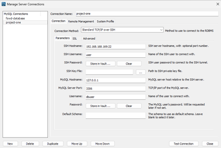

Step 5: Make an Connection for the Database
To set up your database and connect it with the Raspberry Pi using MySQL Workbench, follow these steps:
1. Open MySQL Workbench: Launch MySQL Workbench on your computer.
2. Create a New Connection:
  - Click on the plus (+) icon next to "MySQL Connections" to create a new connection.
3. Configure the Connection:
  - **Connection Name**: Enter a name for your connection.
  - **Hostname**: Enter the IP address of your Raspberry Pi.
  - **Port**: Enter the port number.
  - **Username**: Enter your MySQL username.
  - **Password**: Click on "Store in Vault..." to securely store your password.
4. Test the Connection:
  - Click on the "Test Connection" button to ensure that the connection settings are correct.
  - If the connection is successful, you will see a confirmation message. If not, check your settings and ensure that your Raspberry Pi is configured to allow remote connections.
5. Save and Connect:
  - Once the connection is successful, click "OK" to save the connection.
  - Double-click on the new connection to connect to your MySQL database on the Raspberry Pi.
Now you can use MySQL Workbench to manage your database on the Raspberry Pi.

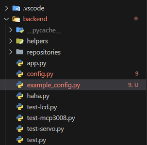

1. Locate the File:
  - In your GitHub repository, navigate to the `backend` folder.
  - Find the file named `example_config.py`.
2. Edit the File:
  - Open `example_config.py` in a text editor.
  - Update the following lines according to the image provided (replace the placeholders with your actual database connection details):
[connector_python]
user = 'your_username'
host = 127.0.0.1
port = 3306
password = 'your_password'
database = smart-locker
[application_config]
driver = 'SQL Server'
3. Rename the File:
  - Save your changes.
  - Rename `example_config.py` to `config.py`.
4. Ensure `config.py` is Ignored by GitHub:
  - Check that `config.py` is listed in your `.gitignore` file to prevent it from being pushed to GitHub.
  - If not, open or create a `.gitignore` file in the root of your repository and add the following line:
   backend/config.py
By following these steps, your configuration details will be used by your application but will not be exposed in your GitHub repository, keeping them secure.
