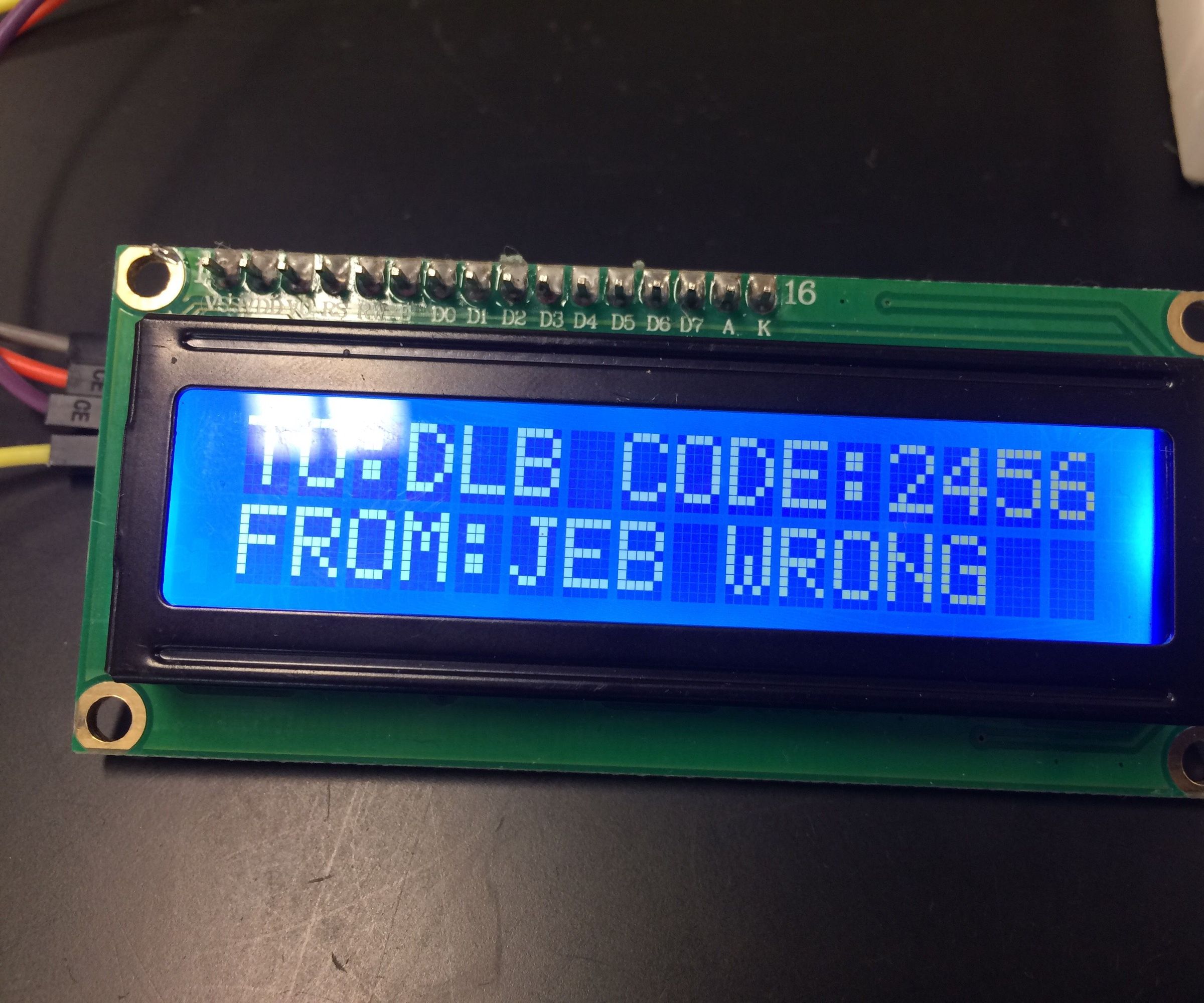

A lockable gift box where you can exchange gifts. The box locks with solenoids. A separate card communicates with the box over RF and has an LCD which displays who the gift is to and who it is from, and has buttons to enter secret and public codes. Enter your secret code to unlock the box and put an item inside, then enter the one digit public code of who the gift is for. Now, only who the gift is for is able to unlock the box.

- lcd screen with 4 pin spi backpack (plug into 5V and ground, the SCL and SDA pins to the corresponding pins on the arduino)

button_client.ino - code for the card with buttons and lcd
- In this file, I created a finite state machine for sending the unlock signal to the nrf chip, checking if the code is correct, and displaying on the lcd.
- I also store the private and public codes in this file for my roommates, so feel free to change the codes and names.
