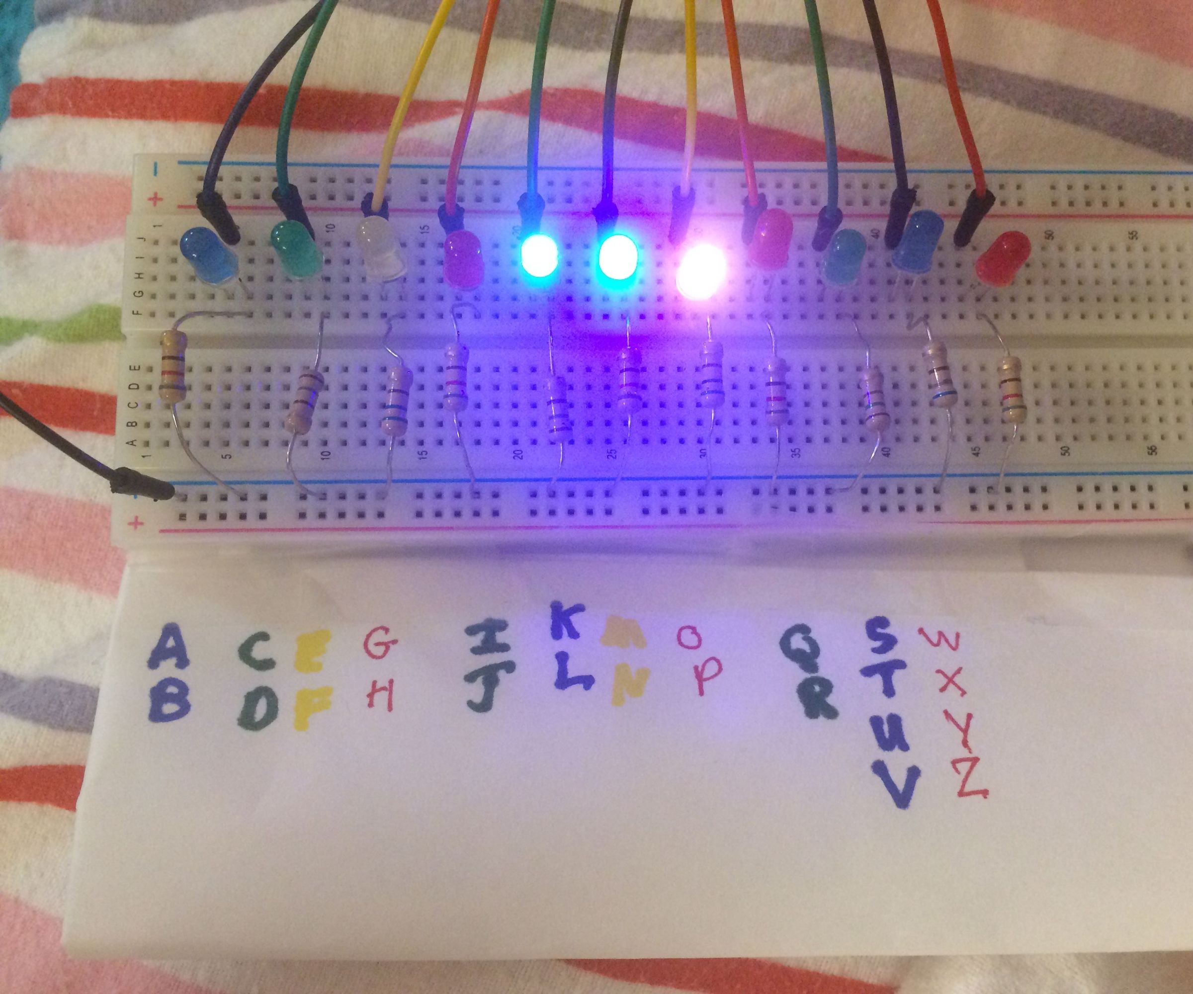

I connected everything according to the picture.
Materials needed:
- Resistors
- Solenoid
- Button
- Potentiometer Dial
- LCD screen with SPI backpack
- Arduino
- Wires
- Transistor
- Diode
- External Battery
In the code I followed a finite state machine setup where once an action occurs, like the button being pressed a certain amount of times, the code goes to another section and waits there until the correct sequence occurs.

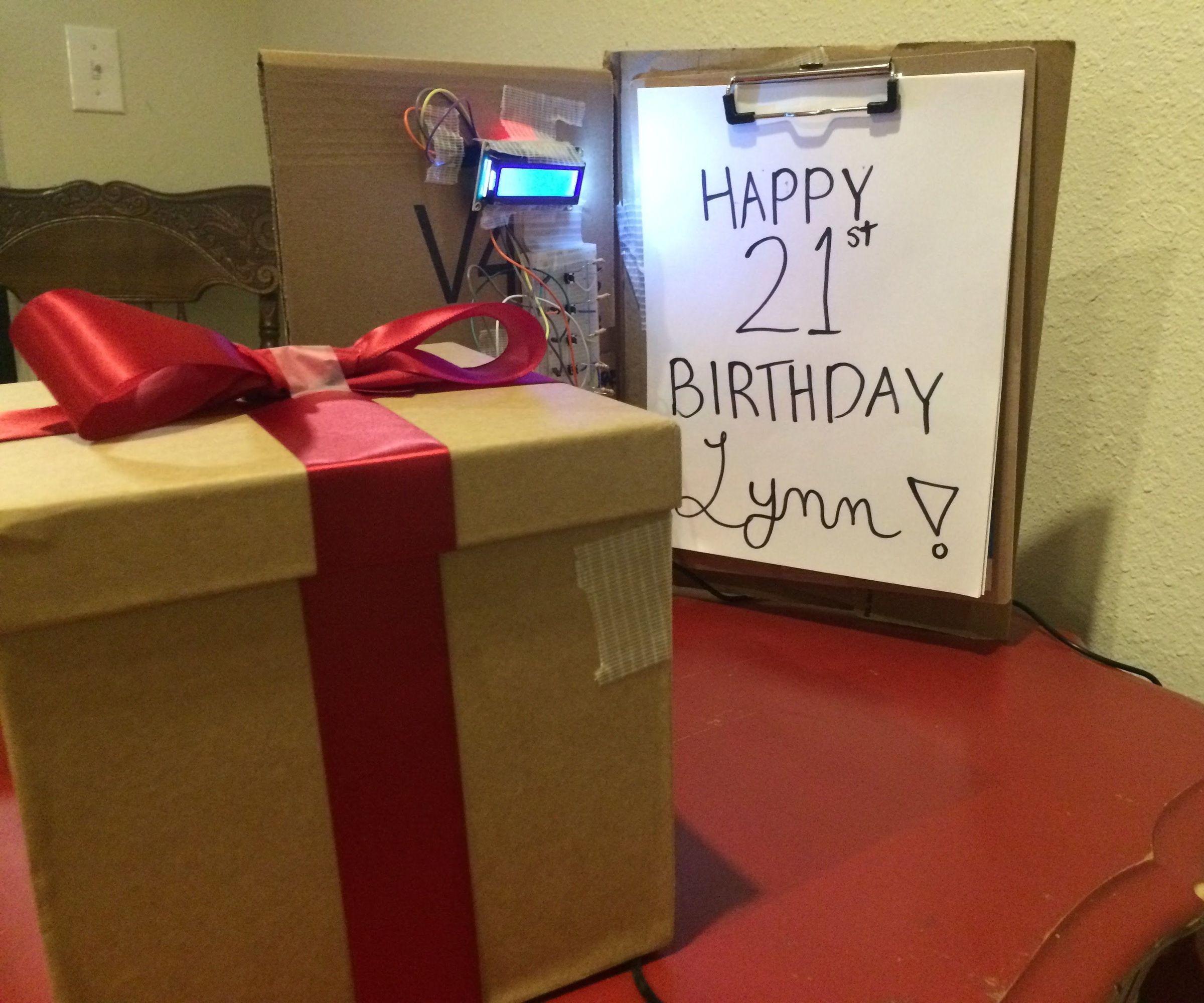

Step 2: 3D Printing
My base contained was two fold. The outer large container is for the gift to be place, and the smaller inner container is for the circuit to hide in. I 3D printed a special lid to house the screen and electronics along with adding a little bit of decoration. I attached the lid to the smaller inner container with hot glue, and burned holes so that the solenoid locking mechanism could slide and fit through.

Step 4: Working Sequence
My design was working before soldering to the perfboard. Above are pictures of the sequence of the lcd screen.
- Hit button to unlock and place item
- replace lid and use potentiometer and button to select the initials of who the gift is to.
- Do the same above but for the initials of who it is from.
- Select a pass code to tell the receiver, clear it from screen, and wait until correct passcode is entered.
