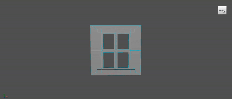

Step 4: Designing the Windows 🪟

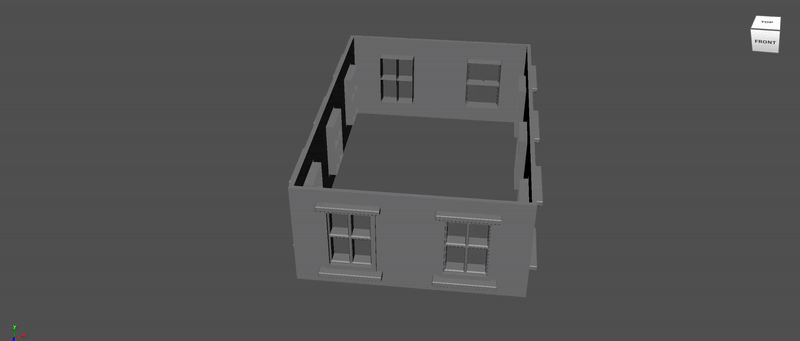

To create light channels, I modeled custom windows using cubes.
- Start with a cube.
- Scale it into a panel shape.
- Use the Edge Loop tool to define the window topology.
- Delete select faces to create holes where light will pass through.

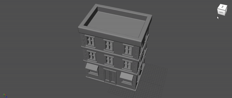

Step 5: Creating a Floor 🔳
Once you’ve got one solid window frame, clone it across to build a floor. But precision is key here—misaligned panels will break immersion.
To align:
- Change the pivot to the bottom corner of your frame.
- Use vertex snapping (hold V) to snap them together edge-to-edge.
- Check from above and below to ensure no accidental gaps.
It’s repetitive work—but oddly satisfying. Like laying bricks for a haunted house.

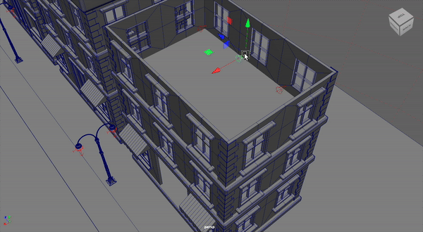

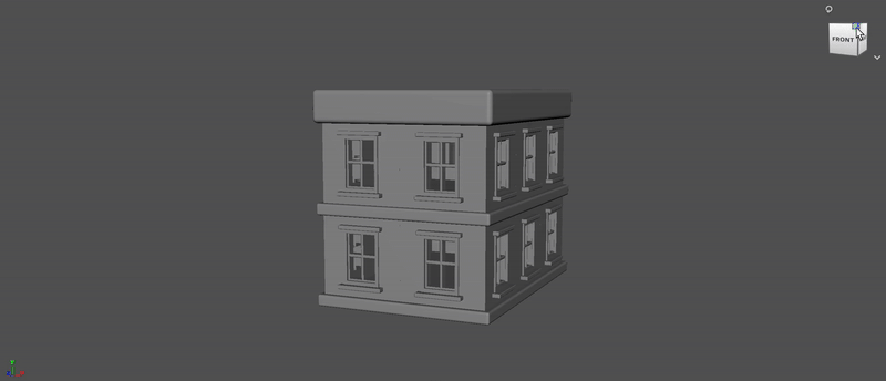

Step 6: Adding More Floors
After one full floor is done, duplicate upwards to build your tower.
This step might seem simple, but keep an eye on proportions. Buildings that are too tall or too short mess with your scene’s depth. I built mine to be just slightly taller than the camera’s frame—so they always feel like they’re looming just out of sight.

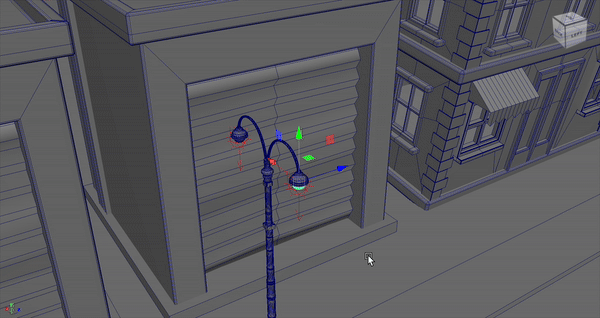

Step 9: Adding Our Streetlights
Streetlights in this world aren’t comforting. They’re watchful. They cast small pools of visibility that only make the surrounding darkness deeper.
I imported a simple lamp model and added an Arnold Photometric Light just beneath the bulb. This simulates natural light falloff—and it looks real.
Keep it dim. The light should reveal as little as possible.

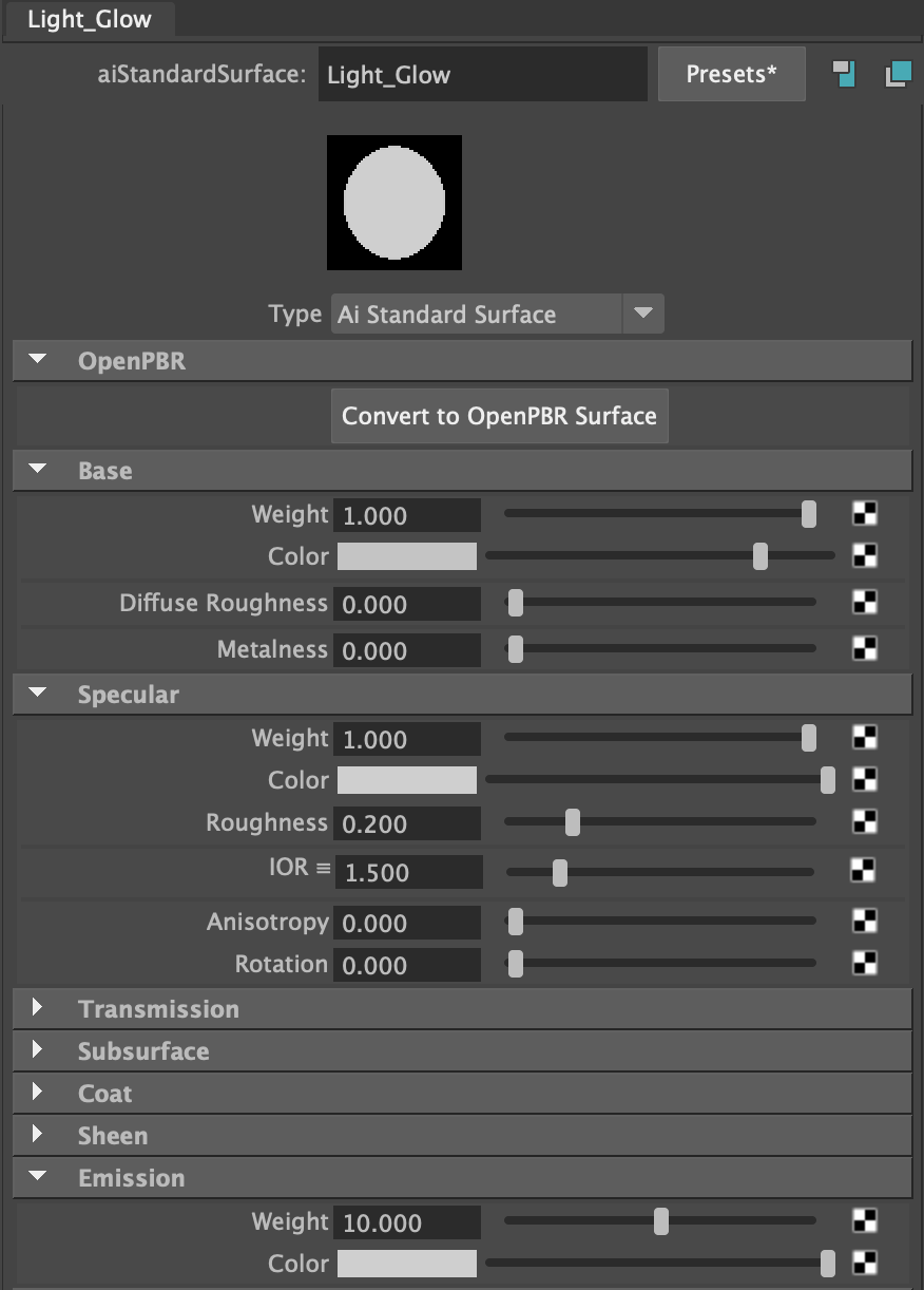

Step 11: Adding Light Builbs to Our Streetlamps
IES lights don’t emit visible geometry, so I added a glowing bulb manually:
- Create a small sphere.
- Assign an Arnold Standard Surface Shader.
- Turn the emission weight up and you can leave the colour as is.
Adjust the glow until it looks like it's alive—but doesn’t overpower the scene.
Once you're done, I assigned it the following Parameters. They helped me get the best glow so that it doesn't overpower the other lights in the scene

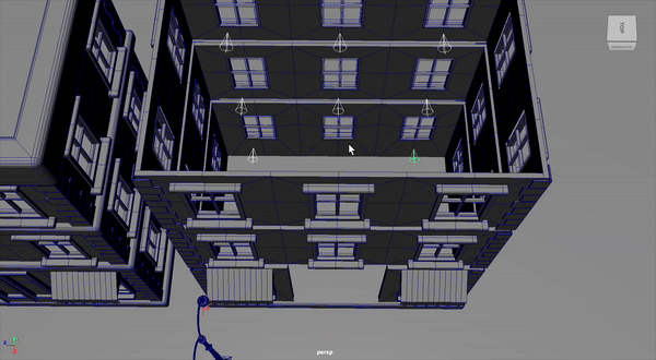

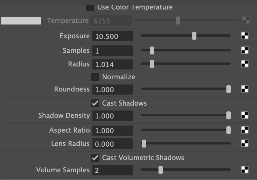

Behind each window, I placed a spotlight pointing outward. The goal is to reverse the typical narrative—where light draws you in. Here, light pushes you out.
Step 13: Final Setup of Spotlights
To finish off the spotlight setup, we need to change the pivot of all the spotlights to match that of the building so that when we make any transform modifications to the building such as rotating them to tilt the buildings then it is also applied to the spotlights. Below is where I set the pivot point of all my spotlights to. I also made sure to set the entire building Groups pivot to the edge of the centre window ledge.
Once everything is set-up, you'll want to create another lighting preset to assign your spotlights. These are the lighting settings that worked best for me. Creating a preset will save you an unimaginable amount of time.

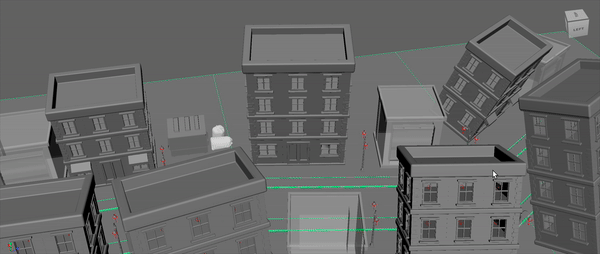

Step 14: More Cityscape Building
Once the fundamental components have been successfully designed, this is where you can add a touch of creativity and finish building our scene. The main changes I made here were to extend the road and add the zig zag effect to emphasise it being a landscape of confusion. I also added a couple of additional props like a trashcan and some trash bags.

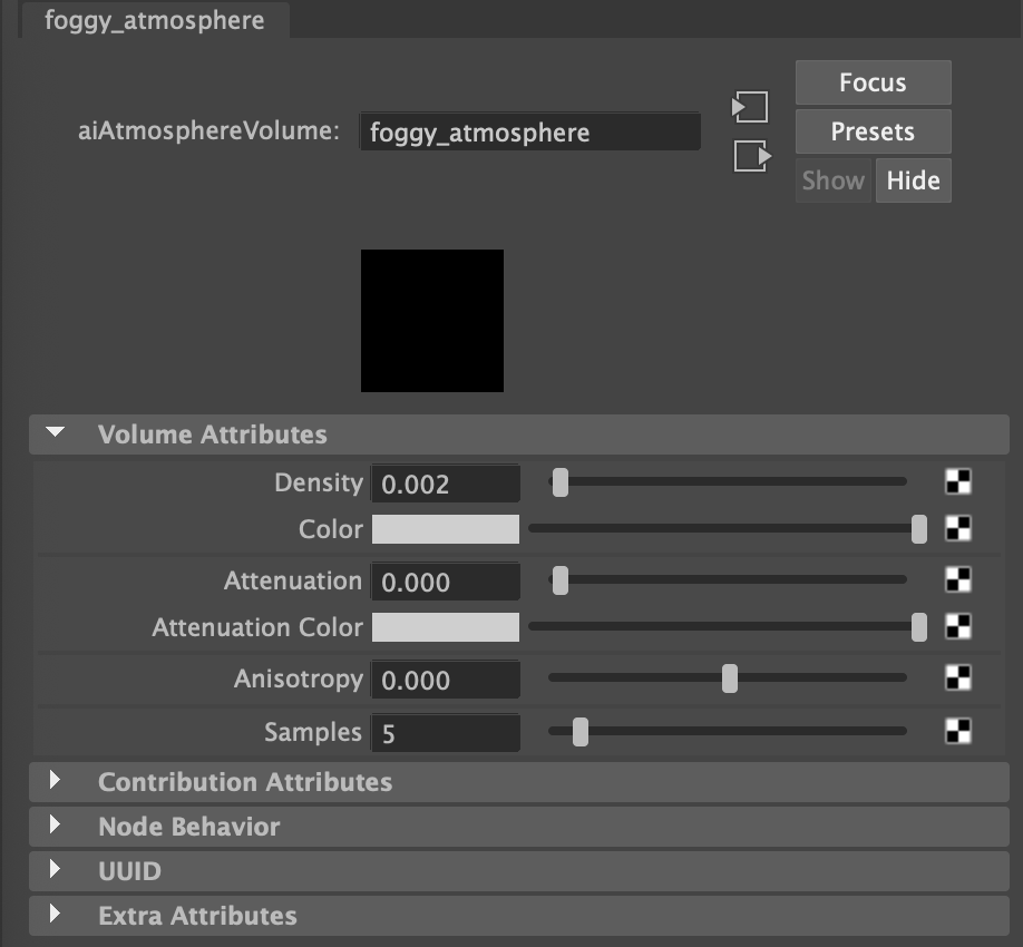

Step 15: Adding the Fog
Fog isn’t just atmosphere—it’s a canvas for light, and it comes in handy a lot in this scene.
In Arnold Render Settings:
- Add an Atmosphere Volume.
- Tweak the density, scatter, and height.
The goal is to make lights “bleed” into the space. It softens the whole look and wraps the scene in haze. These are the parameters I used:
Step 16: Tilting the Scene
Now it's time to bring the scene to life. A normal alley is scary enough at night, but to really put some emphasis on it, we can tilt the buildings 5-20 degrees, choosing whichever makes the scene look the least forced. The tilting of the buildings is also crucial for the spotlights in the buildings. When you tilt the buidling, that's when the lights can pierce through the fog and hit the street, creating that feeling of being watched with a spotlight on you. Compound this with the lights coming from multiple buildings and the scene comes to life quite nicely
