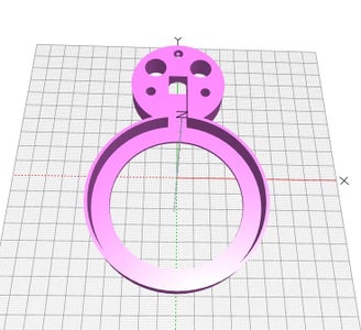

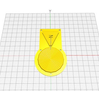

The 3D printed parts were designed using BlocksCAD and consists of two main elements.
1: Levitation Station
Made up of the following:
Head unit - contains the levitation module and power socket.
Head unit cap x 2 - covers the levitation module. (one functional and one decorative)
Tail section - covers the back of the head unit
Light cover - power indicator for the levitating module.
Base unit - contains the induction plate.
Base Spacer - raises thin chargers
Spacer - increases rigidity, individually or stacked. (optional).

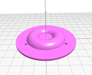

2: Saucer
Dome Window - holds the magnet.
Body - retains and supports all associated elements.
Support - holds the ballast and fixes to the magnet. (2 versions subject to usage)
Base - holds the coil former.
Coil former x 2 - forms the inductive receiver.

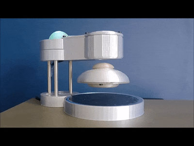

Step 12: Operation
Plug in the power adapters for the LM and the WCP (if included), the power indicators will illuminate.
Active Levitation
Whilst holding the saucer in your hand, position it under the levitator head using your fingers to maintain separation between the two. Adjust the position carefully until you find the sweet spot and the saucer will float.
Inductive Lighting
If the wireless charger is attached the LED's will flash.
During use the unit will become a little warm the wireless charging plate ~20C and the levitating station head ~27C at a room temperature of 19C.
Troubleshooting
The weight of the completed saucer is 38g but this can be adjusted by adding a larger or more washers.
If the saucer keeps being pulled up to the magnet increase the weight a little and if it keeps falling down reduce the weight a little.
Rather than dismantling to make weight adjustments add small amounts of tacky putty for optimal levitation then substitute the same weight internally.
