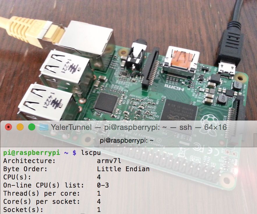

Enable remote access
You can also set up port forwarding, or use a relay service like https://yaler.net/ to remotely access the BeagleBone with SSH. This allows you to conveniently check logs, right from your kitchen table. (Disclosure: I'm a founder of Yaler.)
