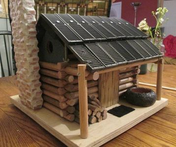

My Mom's birthday is in mid- April. My daughter and I wanted to make her something that she would like, and out of wood. I came up with the idea of a log cabin birdhouse. She could enjoy it every time she looked out her back windows, and it would create some extra activity/entertainment for her. I thought it would also be a bit more challenging to build it to scale(1:12), partially as a way for my daughter to Practice Math. ~ : D

Step 2: Oak Dowels
So many! I think we ended up using (7) 3' dowels. We used a good pull saw to cut them. At first we tried lining several up and masking off where they would be cut. It ended up just being easier to cut each one individually.
They were 36 1/4", and cutting them into 12" for the fronts/backs and 9" for the sides produced no waste. We cut out and chiseled square notches on the 12" ones and rounded grooves for the 9" ones. Then we sanded them smooth with files.
We only grooved out the tops, not tops and bottoms of the logs. It would have been too many dowels to achieve the scale height, and we just lined the inside of the house with sealed cork sheets to insulate the gaps.

I used threaded rod, 10-32, to lock all the logs together.
I tediously drilled holes through all the log ends, using blue tape to reduce splintering/blowout.
A cap nut for the bottom, underneath the platform, then alternately feeding the logs through, then later tightening everything up with 4 wing nuts.

I found these composite shims at Home Depot and thought they'd be perfect. I really liked the shuttered look and the fact that I could bend them for folds at the top of the roof. I used 2 packages of 12. They claim to be weatherproof, so we'll see how they hold up to New England winters!
Eight across would fit perfectly so I started at the center left, pre-drilled and screwed them in, one screw in the front and two screws in the back. I guess I could have used black screws, but these old slotted screws that were just the right length(3/8" and 3/4") were just waiting for the perfect project and here it was. The outside fronts of the shims I cut away small divots to fit around the porch posts.

We gave this to her earlier today. She loved it!
I may put it up on the pole tomorrow or next weekend.
I'll post more pics when I do that, and when she gets her first feathered tenants.
