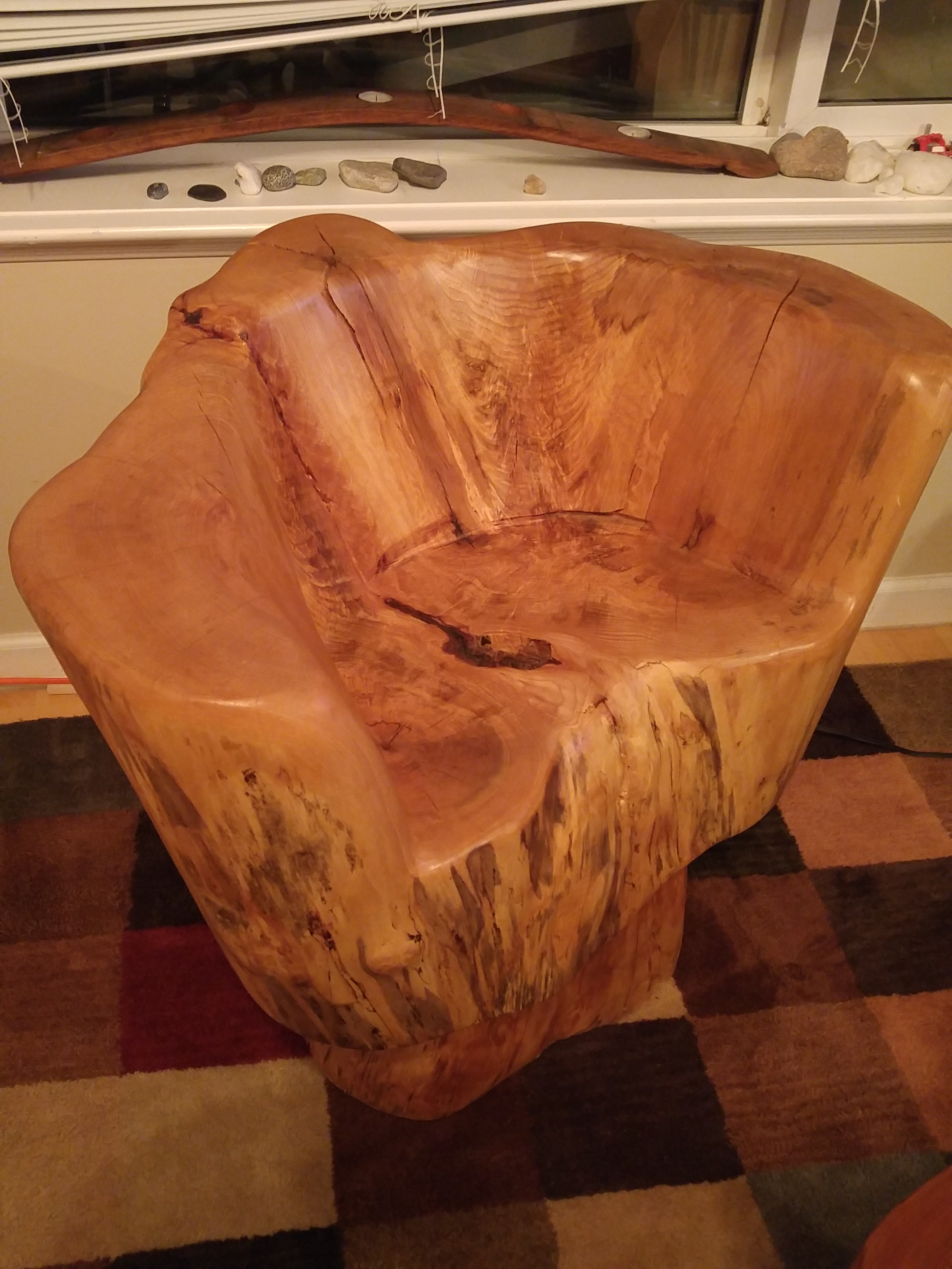

The tools I have are rebuilt or a bit older as I hate to see things set aside if I can still use them. With some new tools on the market there are endless possibilities. These pictures show some of the great tools for carving and finishing that can be used in this type of build. With the small size of carving tools you can really get some good detail in your work, and with the larger tools you can really shape some large pieces of wood.
