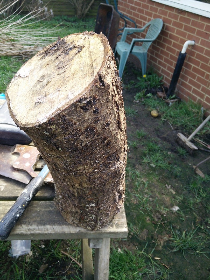

A large log; this can really be any size, but I chose one which stands (on it's own) about 18" tall with about a 10" diameter. I have seen a few of these types of things made directly on an old (still planted) tree stump, which I think is a brilliant way to decorate what is possibly a garden eye-sore.

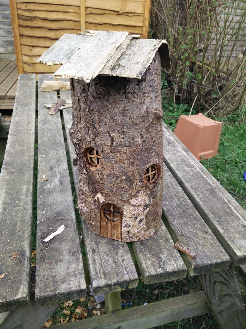

I cut the top of this log to a shape which is 'roof' styled and pinned on pieces of an old, fallen fence to create a roof.
I laser-cut the the doors and windows with a very simple design, from re-sawn 2x4" timber. If you don't have access to a laser cutter, these could easily be made by drawing the design onto timber and cutting with a coping saw.
Behind each window and the window in the door, I drilled out a deeper hole, using a 45mm forstner bit and chiselled out the additional material so that I could recess them into place. A couple of dots of epoxy to make sure they stay in place. Brushed on a couple of coats of dark wood stain and a coat of varnish to help protect the wood from the elements. For a first attempt, this was a very simple project and the kids are fascinated by our new garden feature and the idea that fairy houses come to life at night.

Hindsight tells me that I should have put the door higher up (not at the very bottom) as the visibility is a little obscured when the log is standing in amongst the garden plants.
