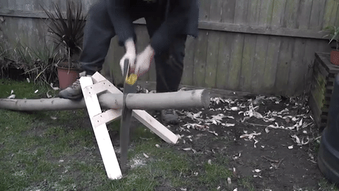

I made the two legs 65cm (25 9/16") long each and then laid the first straight piece along them where I wanted it to be joined. The angle of the legs is entirely up to you though I think making them angled too far out would make your log closer to the ground and so there'd be less room for your saw to move. On the other hand making the legs too close to each other will make the device less stable, so you have to find a middle ground there. I'm sure there's many different designs to look at though.
The top straight piece was 6cm (2 3/8") down from the top of the inside of the legs, the space between the two straight parts is 12cm (4 3/4"), this is where the log will sit. Once you have those roughly in place you then have to measure down each leg to make sure the straight parts are an even distance from each other,
When everything is lined up, all that's needs to be done is mark on the legs where the straight parts will sit. After that you take the legs and draw the lap joints half way down the side of each of the legs as seen in the photos.

So the frame is all cut up and ready to assemble. I decided to clamp the pieces down whilst I drilled the pilot holes for the 8 screws, 2 screws in each joint. After the pilot holes were drilled I screwed the screws in part way, put glue on the joints and then screwed the pieces together. I always like to get the screws ready before getting the glue on, it just seems to make the process more relaxed and less panicky.
Step 5: Saw a Log!
It'd probably be advisable to let it dry for one day but I decided to try it straight away! All you have to do is slide your log through the hole and angle the legs so the log clamps inside the top and bottom straight pieces of the holder. Put your foot on the part of the log the other side of the holder to create pressure and keep the log in place, then cut away to your hearts content.
