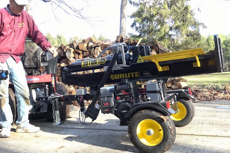

Adjusting the log splitter from horizontal to vertical configuration takes 70 lbs of vertical force at the operator’s handle to lift the beam handle which is 42” horizontal from the pivot point. Since the actuator’s lifting point is located much closer to the beam pivot point, it takes about 196 lbs of vertical force from the actuator once mounted into position.
Actuator vertical force applied = Operator applied force * (Operator lifting point / Actuator lifting point)
Actuator vertical force applied = 70 lbs * (42”/15”)
Actuator vertical force applied = 196 lbs
The formulas in the Excel spreadsheet were used by Ron to help him calculate and home into the final actuator coordinates that were chosen. Many possibilities were tested and generated, however, the best coordinates were chosen and kept so the spreadsheet could remain tidy. Being rated for 850 lbs of dynamic force allows the PA-17-24-850 to have plenty of room for a good safety margin. The derated vertical force capability of the actuator based on the final coordinates is 699 lbs. This equates to about a 3.5X safety margin when considering the force applied will be about 196 lbs.
Safety margin = derated vertical force capability / vertical force applied
Safety margin = 699 lbs / 196 lbs
Safety margin = 3.57

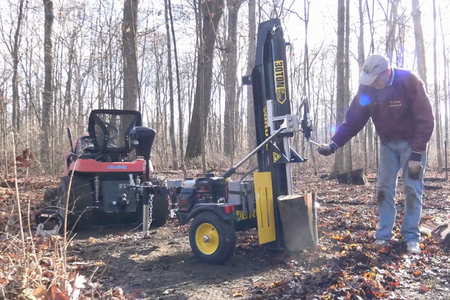

Step 6: Operate the Upgraded Log Splitter
During operation, Ron found his actuator’s typical current draw at about 3 amps and may spike briefly to about 5 amps on starting. Raising the bream takes about 36 seconds while lowering the beam will take about 38 seconds. Our BRK-17mounting brackets were used to secure the front and rear mounting holes of the PA-17 actuator while still allowing for 180-degree rotations. The rest of the structure was constructed primarily of 80/20 extrusions of series 1010 and 1515 combined with aluminum angle brackets and plates.
Check out the video of Ron’s upgraded log splitter in action!
