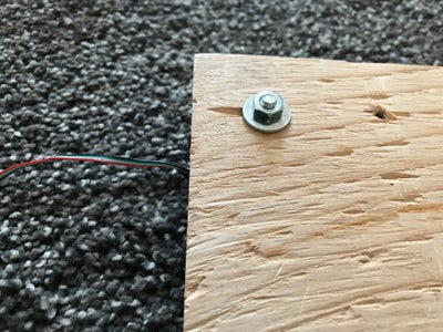

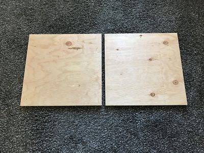

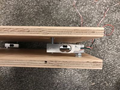

Step 3: Building a Weight Scale

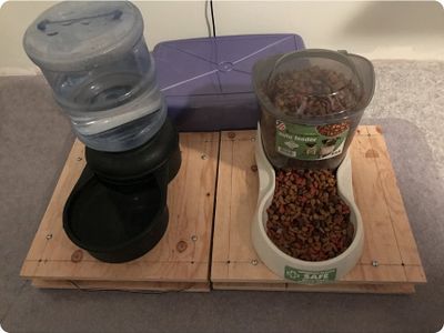

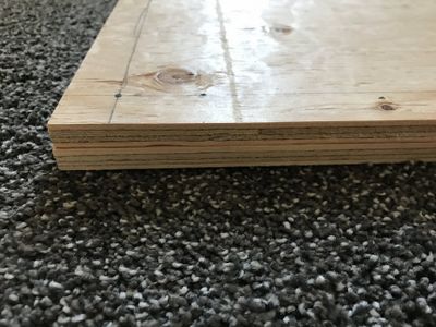

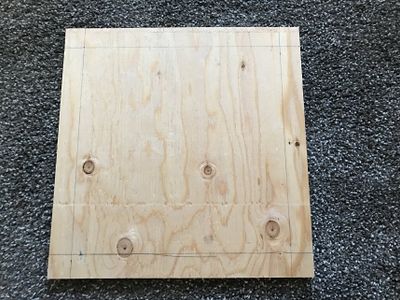

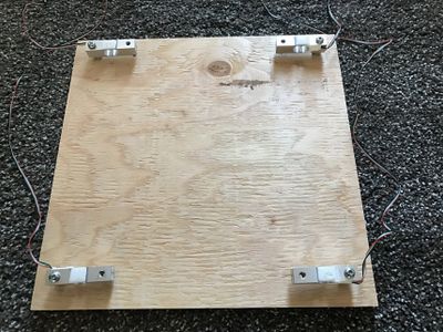

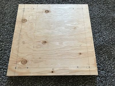

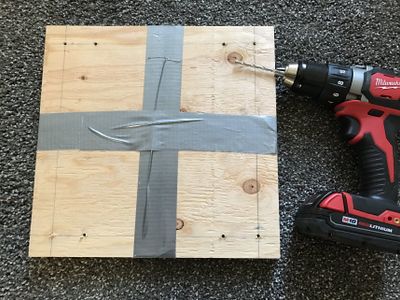

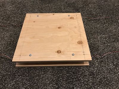

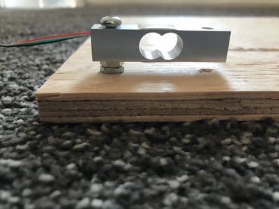

The first thing to do for this project is build the weight scale!
We chose 1/2" plywood, but you can use whatever you have around, just make sure there is enough room for the load cells to flex and that the material can withstand the load.
You will need one scale for the weight bowl, and one for the food bowl, and one for your pet. We made the food bowl scales 12" x 12" and the pet scale 24" x 24".

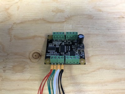

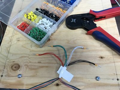

Step 4: Wiring the Weight Scale

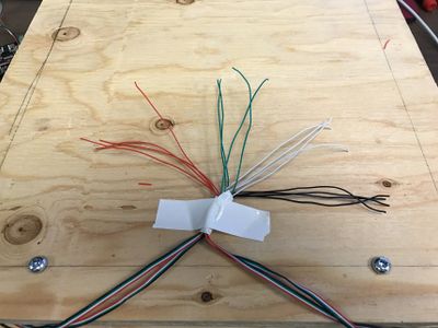

After building the scale, the next step is to wire it up.

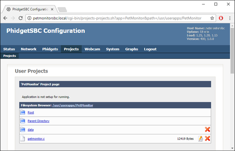

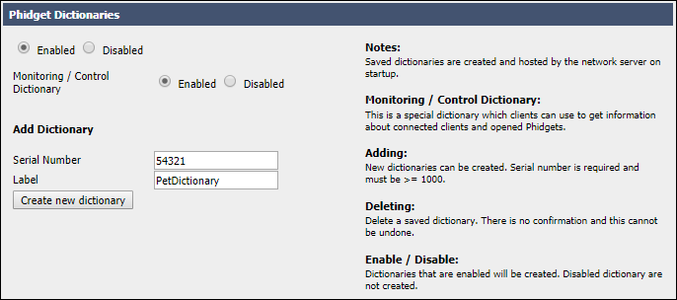

Step 6: Setting Up the SBC4
If you have never used a Phidget SBC before, first follow this getting started guide before you continue reading.
You will need to do a few things to your SBC before getting started with this project.
  • Create a PhidgetDictionary (see picture above)
  • Create a project (see picture above)
  • You will need access to the terminal in order to compile the C program, so you will need to enable SSH. You can see how to do that here.
  • Install C/C++ packages. You can see how to do that here

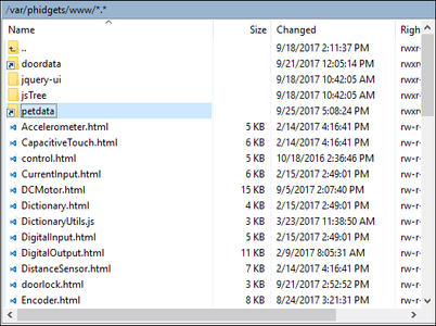

  • You may have noticed the data folder in the project directory in the image above. We will be logging information about the pet's weight to a file and that is located in the data folder. You will have to create a link to this folder from the webserver docroot location (/var/phidgets/www), so that the webpage can access the information. Here is how to do it using WinSCP.

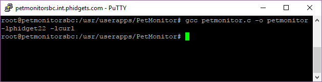

You will also need to compile the C program, which can be done by entering the following command into the SBC terminal:
gcc petmonitor.c -o petmonitor -lphidget22 -lcurl
