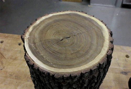

Step 1: Source Log
To make a log box you're going to need a largish section of log. Your needs will dictate the size of your source log, mine was roughly 18" (46cm) tall, and 13" (33cm) in diameter. The ends will be trimmed up to square the log, so chose a section of log that is longer than the final dimensions you are going for.
I found this log on the side of the road. You can usually find logs like in the free section in your newspaper or local listing, or maybe from the place where you get firewood. There was a variety of types of wood where I got my wood, I found a straight section of wood which turned out to be Black Acacia. This wood has a great dark heartwood and is very dense. The California Invasive Plant Inventory lists Black Acacia as invasive-limited, meaning "it may be a locally significant but not a state wide problem, or too little is yet known about it".
The log I used was 'green', meaning it has a high internal moisture content from not being dried. Green wood is any wood with an internal moisture content of about 12% or more. This is important as wood that has not been dried will start drying and reacting when you begin working with it, whereas dried wood is typically dimensionally stable when the moisture content has been removed. Wood needs to be milled into manageable planks in order to dry effectively, and even though my log appeared to be mostly dry it would be impossible to tell the moisture content until it was opened up.

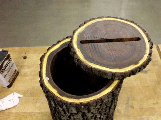

Step 29: Sealing
After sanding I wiped on a few coats of Danish Oil to bring out the colour of the wood. Black Acacia looks a little dull when unfinished, with a few coats of Danish Oil I think it looks rich and stunning.
I wiped the top and bottom of the pivoting top, and all inside the hollowed log.
Step 30: Test Finished Action
With the magnets glued in place, and the coats of Danish Oil applied you can test the action of the top. You can see the top register in place when the magnets get close.
You can now glue the pivot dowel into the top of the log box. Leaving it unglued on the bottom will allow you to remove the top completely later, and rotate the top. To smooth the pivot action you can apply a small amount of wax to the unglued opening on the top.

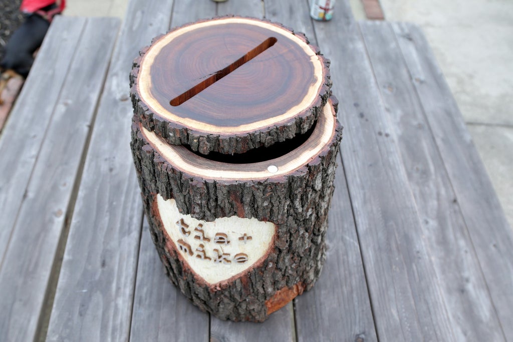

Step 31: Heart Template
With the box functionally complete I moved onto decorating the outside. I printed a heart shape on my computer printer and taped it to a flat section on the outside of the log.
Step 32: Tape Template and Chisel
Using a sharp chisel I hammered away the outline of the heart. Once the outline was traced I removed the paper template and worked around the outline a few more times to separate the bark from the bare wood, then used the chisel to pry off the bark inside the outline.
Since my wood was still a little 'green' I let the fresh opening dry out overnight.
Step 33: Clean Edges of Cutout
Once the heart shape was completely dry I cleaned any rough edges with sandpaper, then sanded the heart shape surface smooth.
Step 34: Add Lettering
You can use any lettering or design you want inside the heart shape, I chose lettering to spell out names.
These letters were cut on a laser cutter, but stamped or die cut designs would also work well. I think anything with some depth definition will really work with this project.
Step 35: Glue Lettering
To glue my lettering to the log I used my favourite adhesive, E6000. This stuff bonds anything to anything, it's like magic.
A small dab of glue was applied to the backside of each letter, then carefully arranged inside the heart shape and left to dry overnight.
Step 36: Place Your Rustic Log Box
Your natural log box is done and ready to collect cards and well-wishes as part of your rustic wedding, or other event. This log box is sure to be a very attractive addition to your next party or summer wedding.
The top of the box pivots open to revel a very spacious interior. Maybe after the event the top can be removed and the hollowed section can used as a planter box in your garden? I'll let you know how I use my log box after it's had its big day in the spotlight.
