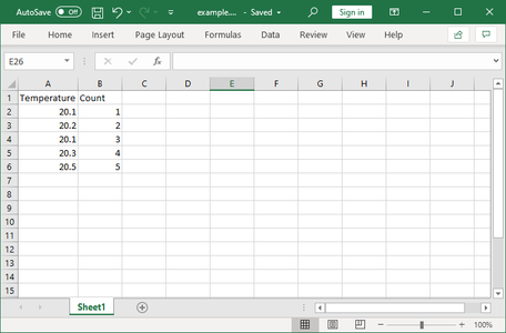

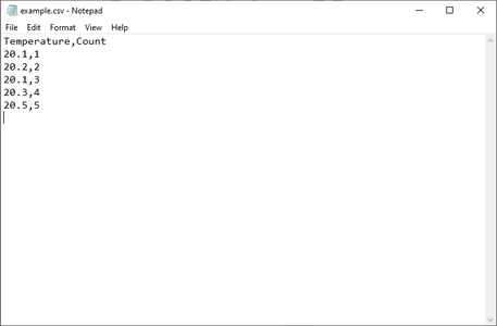

Step 5: What Is a CSV and Why Use It?
CSV stands for Comma-separated Values. As the name suggests, you create a CSV file by simply writing data to a file as a string, and using commas to separate values. The benefit of using CSV files is that they are easy to generate (as shown in the code above) and you can open them with any spreadsheet program, like Microsoft Excel, to view and manipulate your data.
In the images above, you can see a CSV opened in Excel, and the same file opened in Notepad. As you can see, the values are simply separated by commas. When writing these files from your code, you can move to a new line by adding the newline character “\n” which is shown in the code above.
