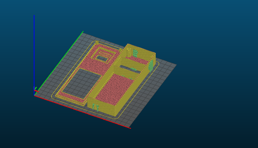

Step 2: Print 3D Printed Parts
  1. Download the Files which were created in Fusion 360 and place them into the slicer of choice (I use Slic3r and the files have somewhat been optimized for them. The top may have to be reposition and all of the prints should have the largest flat face on the build plate.
  2. When slicing the files the usb port opening on the bottom case does not need supports if the slicer does not remove them for being too thin. A 0.4 mm nozzle was used to print the examples shown in this Instructable.
  3. The two large pieces of the case can be printed at the same time on an 200mmx200mm printer as shown in the screenshot.
  4. Two of the tabs will need to be printed also bringing the total 3D printed part count to 6 pieces.
  5. I have included the top and bottom of the case as Fusion 360 Archive Files (f3d file type) incase anyone has fitment issues due to slicer or printer since they were designed with offsets from the printer I was using.
