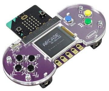

- Kitronik ARCADE for micro:bit and MakeCode Arcade
This article uses the Kitronik one. It features:
- A 1.77" colour screen using the MakeCode Arcade standard resolution of 160x120 pixels.
- Powered by USB connector on micro:bit V2 or 3 AA batteries (alkaline or rechargeable NiMH).
- The five micro:bit pads, 3 GPIO, 3V and GND are replicated at the bottom.
- It uses the small speaker on the back of micro:bit V2.
