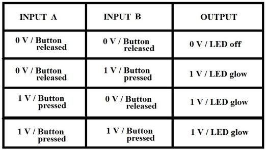

Step 4: OR Gate
- On a Perfboard arrange the components(3 LEDs, 4 Pushbuttons and 3 resistors) as shown.
- The soldering should be done by making the appropriate connections.
- connect the +ve terminal of LED(the longer terminal) with the resistor.
- The circuit diagram as shown is for Simplicity.After connections and soldering is done, connect the batteries at respective terminals, and we are ready.
- Both Buttons are to be pressed simultaneously for indicating input.
- You can refer to the Truth Table given.
