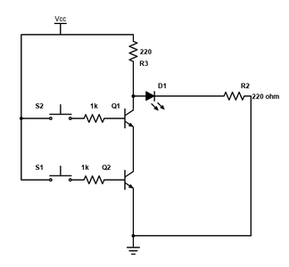

Step 2: AND Gate
AND gate is the basic logic gate that implements logical conjugation. It has two binary inputs which give one binary output.
The logical expression for AND gate can be given as C= A^B or C= A.B C is the output with A and B being Inputs.
·       F =AB
Discussing the Expression:
F means our Binary Output which will be equal to the product of two binary Inputs A and B. If we multiply them we will simply be left with one output which will also be the binary output.
For instance, the Product of 0 x 0 = 0, and the product of anything against Zero is also zero. But Product of 1x 1 = One.
The symbol for and the gate is above the figure. Truth Table is also given above.

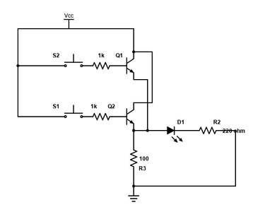

Step 3: OR Gate
The OR gate is a digital Logic gate that implements Logical Disjunction from mathematical logic. Analytical representation is
·       f(a,b) = a+b – a*b
·       F = A+B
F means our Binary Output which will be equal to the Sum of two binary Inputs A and B. If we add them we will simply be left with one output which will also be the binary output.
For instance, Sum of 0 + 0 = 0, Sum of 0 + 1 = 1 But Sum of 1 + 1 will also be  equal to 1 .

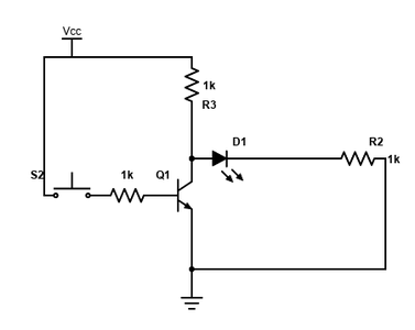

Step 4: NOT Gate
Not gate which is also known as Inverter Logic because it inverts the inputs. And from mathematical Logics, it implements Logical Negation. It has one input and one output which is basically an inverted output.
Its analytical representation is:
·       f(a) = 1-a
·       F= A’
F means our Binary Output which will be equal to the inverted or complement of binary Inputs A.
For instance, If at Input We have 0 then after inverting we will get 1 at the output and the same for 1 which will be the 0 after inversion.

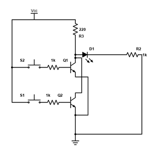

Step 5: NAND Gate
NAND Gate is one of the universal gates. It is a logic gate that produces an output which is false only if all its inputs are true; thus its output is complemented to that of an AND gate. NAND Logic gates logic can be expressed as:
·       F= (A*B)’
F means our Binary Output which will be equal to the complement of the product of two binary Inputs A and B. If we multiply them and invert the result we will simply be left with one output which will also be the binary output.
For instance, the Product of 0 x 0 = 0 but after its inversion, we get 1, and the product of anything against Zero is also zero but after the inversion of Zero, we get One. But Product of 1x 1 = One and its inversion is 0.
Symbol and Truth table are given above.
